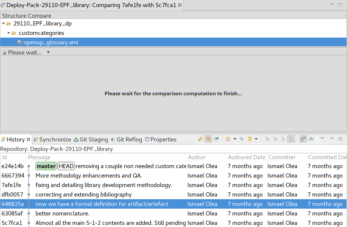

I'm poking a bit with EMF Compare. I'm working with EPF Composer models managed in a git repo so seems Compare is the right tool to manage development collaborations. Well, when trying to make comparatives I get a set of errors like:

I followed an advice and added by hand the related ecore files to the workspace and relaunched Eclipse. I tried comparing again and... good news: now it doesn't break!
The bad news are... this is computing for 10 hours and still didn't finished o_0
The metamodel I'm using weights about 150Kb.
What could I'm doing wrong?
