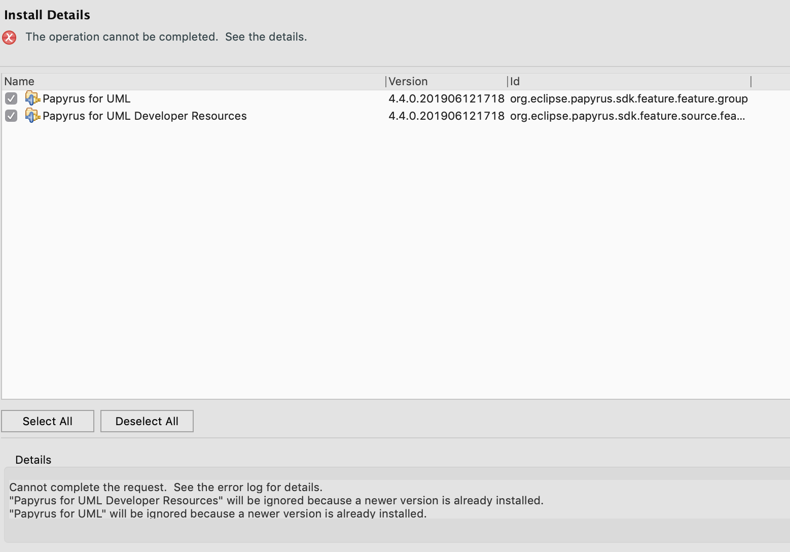

I have Payprus IDE installed with the following version:
Version: 2019-03 (4.11)
and want to upgrade to version 4.4 and I added the update site:
"http://download.eclipse.org/modeling/mdt/papyrus/updates/releases/2019-06"
to "available update sites".
However, when I select the the items for update (papyrus 4.4), then IDE says:
"a newer version is already installed." But this is not true, actually I have the older version (2019-03 (4.11) installed.
How can I upgrade papyrus ide?

I am a bit confused by how you ended up like that. By Papyrus IDE do you mean the RCP corresponding to the 4.3.0 release ?
Could you link a screenshot/txt file of your 'installation details> installed features' so as to get a better idea of your setup and the Papyrus version (not the IDE/RCP listed version) ? (there is, by default, an update site to the nightly version of papyrus so you might have checked out that one before.)
Then again, even if the RCP was configured to be upgradable (on the Papyrus end of things) the platform/ide itself was not designed to be. so it might end up breaking your installation depending on the evolutions of the released material.
You might be better off downloading the latest RCP and setting/migrating your workspace to it.

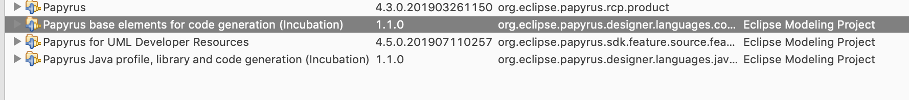

Ps: btw, looking at your latest screenshot you do have a more recent version of Papyrus than the 4.4.0 (2019-06) as you have updated it to the nightly 4.5.0.

Yes, 4.5 is the newer one, however,. I also want to update this component:
Papyrus	4.3.0.201903261150	org.eclipse.papyrus.rcp.product
by using the nightly update site.
The actual version must be higher than 4.3.X.
The update site "http://download.eclipse.org/modeling/mdt/papyrus/updates/nightly/master/" does not provide a newer version than 4.3.
So which update site should I use to upgrade ALL the papyrus components?
