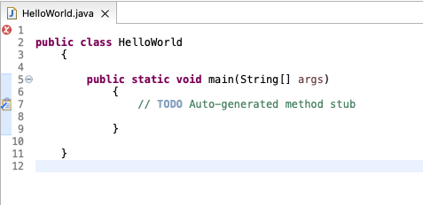

It sems that the cheat sheet is out of date. There should be a step for package creation after project creation and before class creation.
However, at least my 2022-09 JDT complains of missing package declaration as soon as the source is opened in the editor, see the red error mark at top left.
index.php/fa/42543/0/
