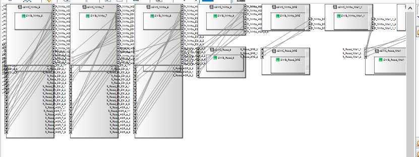

All I am using custom layout provider to increase the size of container based on border nodes. It is working fine It is increasing the size.But if I import any big file containers are overlapping.

There is a problem if I import big file containers are ovelapping.Please find the attached screenshot .Please any one help me how to avoid overlapping of containers

Layouting is a very complex matter. Since you are doing the layouting with your own code that we don't have access to or that we don't have enough resources to debug your case, we cannot help you with that.
But from what I understand first you retrieve the layout that does not take in consideration your constraint then you change the sizes. The layouting did let enough space between container that you grow bigger because it cannot know. So you have the overlap. You have to also change the positions of containers to remove this overlap. Sirius cannot do anything for you. It is up to you.
