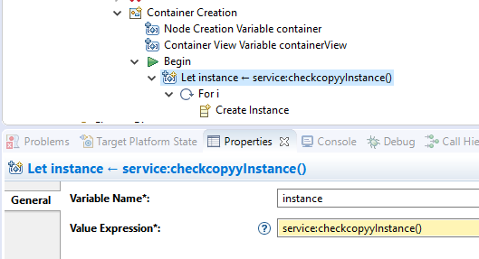

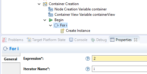

I will provide a screen shot where in design I have used 'for loop' for creating instances but it is not creating.

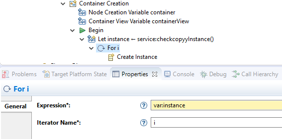

Thank you for the reply. But I am still facing the issue Iam not getting how to use open wizard operation in design. I have searched for so many examples but still I didnt find how to use it.
I have tried using let operation after that for loop operation after that createContainer operation but still it is creating for once.
I will give you the screenshots of design.Please help me I am trying these from one week

Re: How to create more than one instance in sirius through design [message #1809064 is a reply to message #1808987] Mon, 08 July 2019 04:26 Go to previous messageGo to next message
The loop operation need to return a list of object so it cannot work with a number.
But even with the right type , it does not work.
So you will have to create the two instance from a service yourself.
To do that you can use the let operation specifying the number then use a change context under where you call your instances creation service.
