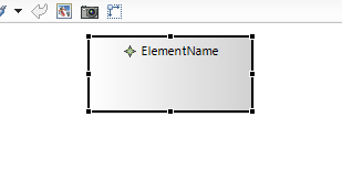

Hi all,
I am trying to create custom tab bar so that I can remove some tab bar icons.
I created a custom tabbar using org.eclipse.sirius.diagram.ui.tabbarContributor extension point as in
https://www.eclipse.org/sirius/doc/developer/extensions-provide_tabbar_extensions.html
As my requirement, some icons are hidden but the issue is Autosize is not working properly. When I create an element the autosize is enabled by default(Autosize should be disabled as the newly created element is by default autosized.) and it is not working when I change container size and then do autosize.
index.php/fa/35855/0/
I have added diagramElementContributionItems.add(createAutoSizeContribution(part)); in getDiagramElementContributionItem but still that is not working.
But then when I switch between diagrams it will work fine like when we use default tab bar.
  • Attachment: Autosize.PNG
    (Size: 3.81KB, Downloaded 432 times)

It is a bug. I have made a ticket https://bugs.eclipse.org/bugs/show_bug.cgi?id=549004
