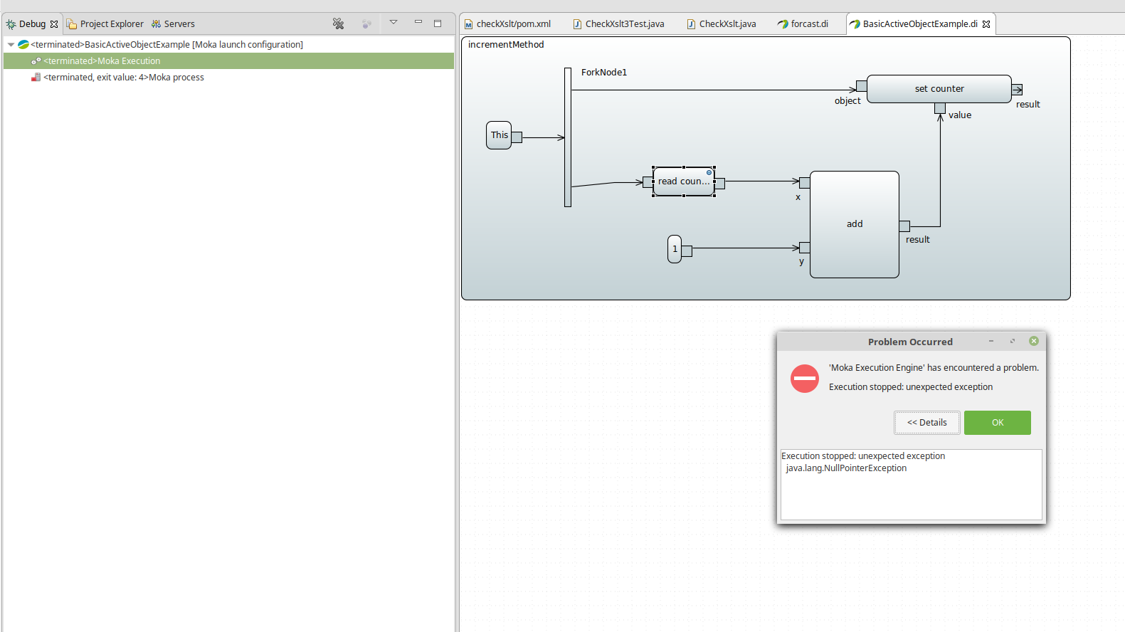

I also tried to get started with Moka, installed it to Eclipse 2019-06 from the update sites mentioned in Getting started with Moka. Downloaded File:BasicActiveObjectExample.zip, set a breakpoint and run in Debug. It led to Nullpointer exception.
What can I do? Is 2019-06 too new?
Re: Moka Statemachines - NullPointerException [message #1809160 is a reply to message #1809135] Wed, 10 July 2019 07:11 Go to previous message
It did not help to install everything fresh: eclipse modelling 2019-06, Papyrus from update-site, Moka by moving the Install button to the workspace. The nullpointer exception remains after start debugging. Is the example BasicActiveObjectExample compatible with these versions?
