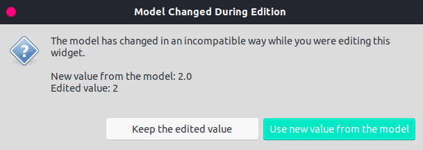

I created a properties page with Sirius to edit EDouble attributes of EMF Objects by using a Text-Widget. This works fine if the entered value actually is a double. So if I enter '1.0' there is no problem. If I simply enter '1', an error message is shown (see attachment). I understand that the 1 is parsed to a double and then set as the new value, which causes the model and the view holding different values. But is there actually a way to deactivate this error message?
In my case it is useless, because the view is updated immediately after I enter the new value and it's displaying the 1.0 while the error message is still showing (I set the 'Force refresh' to true of the dynamic mapping that creates the Text-Widget). When I press one of the buttons in the error dialog I additionally get a SWT-Exception that tells me 'Widget is disposed'.

This seems to be a bug. You can create a bu ticket on https://bugs.eclipse.org/bugs/enter_bug.cgi?product=Sirius
Nothing you can do.
