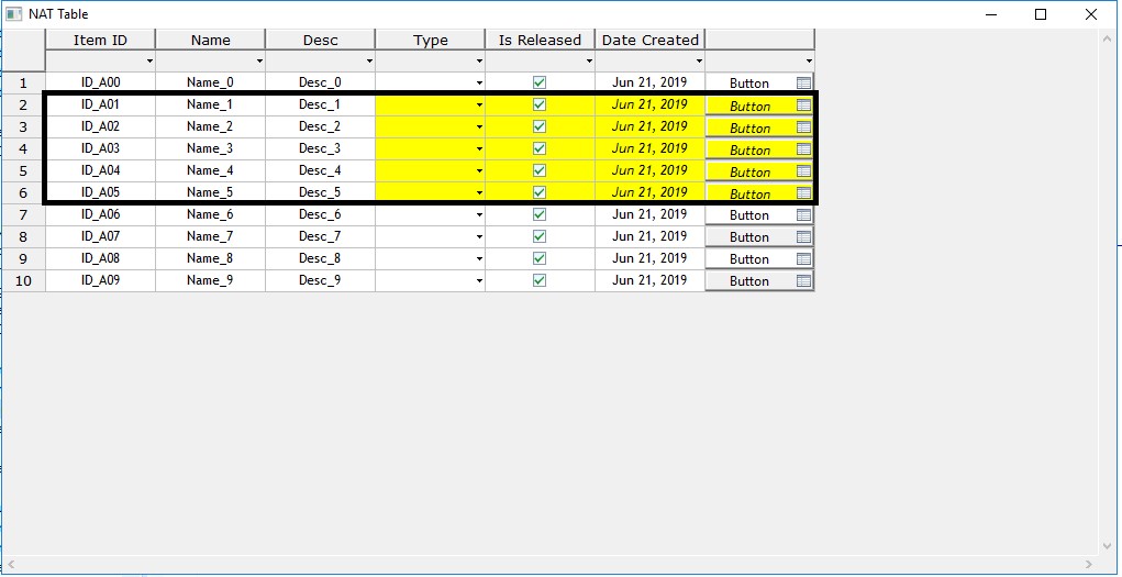

I have a nattable implementation , where few cells in some of the rows are made non editable; highlighted in yellow in attached image(beforeSort.jpg).

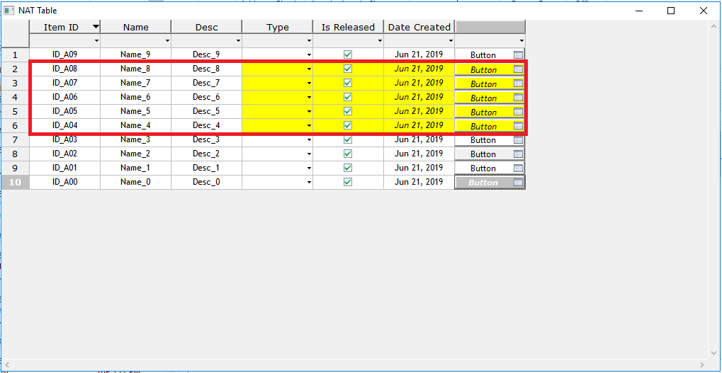

my nattable has single click sort configuration. when i click on column header to sort the table rows, the data is getting sorted correctly, but the labels not re-arranged, instead the labels are still showing up at the same cell position as they were before sorting.
i want my labels to also get moved to the new sorted location of the row.
i am applying label by overriding the getConfigsLabelByPosition method from bodyDataProvider. Sample Code is attached.
Same issue also observed with Filtering.
Can you please help me to achieve this.

i think the styles that are being applied are for a particular cell position, and on sorting the cell styles are not re-evaluated based on new row positioning after sort.
Is there a way to achieve this. as my custom style labels are based on particular value in that row.
Re: Sorting Not honoring applied style labels [message #1808373 is a reply to message #1808372] Sat, 22 June 2019 08:36 Go to previous message
Maybe your example is slightly different, but you make the same mistake. You show the SortedList but you perform your check on the base list. The sorting is applied on the SortedList so you need to perform the checks on the SortedList, not on persons.
