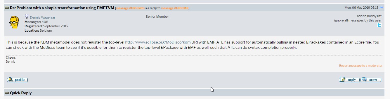

I'm working with KDM package called "Structure", but when I put:
-- @nsURI KDM=http://www.eclipse.org/MoDisco/kdm/action,
the Structure elements are not recognized, and when I put:
-- @nsURI KDM=http://www.eclipse.org/MoDisco/kdm/structure,
the elements of Code/Action package are not recognized.
Now, I'm trying with:
-- @path platform:/resource/ExampleEMFTVM/Input/kdm.ecore,
but is not working...
How can I configure the KDM metamodel for working with all the packages?
PS: Attached is the suggestion of the ATL team to the problem described.

This looks more like an ATL problem indeed.
One possible trick could be to create an artifical Ecore (meta)model that would have links to all the required KDM packages.
Hopefully, by putting this metamodel as the input/output of your transformation, ATL could be able to load all the underlying KDM packages... but then I don't know if the code completion feature is actually supporting this particular case for example.
Anyway, I guess a solution may already exist somewhere in the ATL forum.
