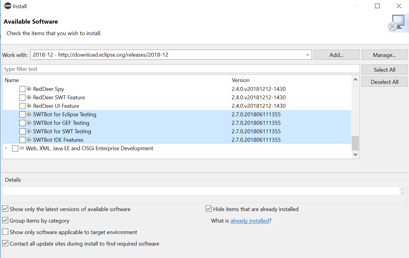

Re: After Xtext 2.18.0 migration, SWT Bot is not installing [message #1808016 is a reply to message #1808014] Fri, 14 June 2019 01:53 Go to previous messageGo to next message
Its there inside Testing.
I have attached screen shot.
Virag Purnam

Re: After Xtext 2.18.0 migration, SWT Bot is not installing [message #1808017 is a reply to message #1808016] Fri, 14 June 2019 01:57 Go to previous messageGo to next message
this is not the market place you told before
which features do you select?
(the for you have work fine if i install them from
https://download.eclipse.org/technology/swtbot/releases/latest/)
[Updated on: Fri, 14 June 2019 01:59] by Moderator
