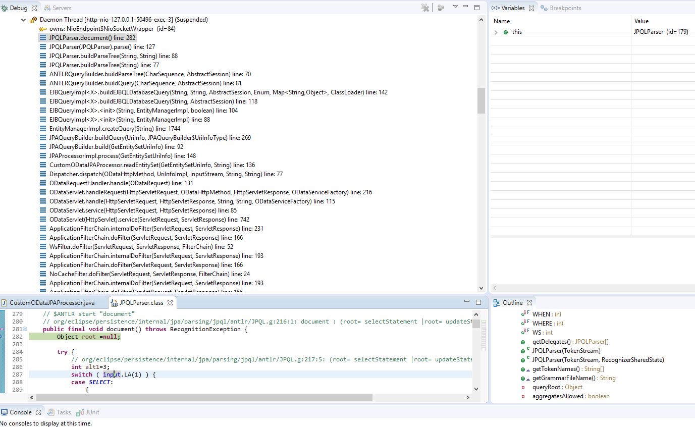

For a lengthy query in a production environment like:
Service?$filter=((SUBSCRIPTION_ID%20eq%20%27BDMASUBS2000000058915322%27)%20and%20((SUBSCRIPTION_VERSION%20eq%201)%20or%20(SUBSCRIPTION_VERSION%20eq%201)%20or%20(SUBSCRIPTION_VERSION%20eq%201)%20or%20(SUBSCRIPTION_VERSION%20eq%201)%20or%20(SUBSCRIPTION_VERSION%20eq%201)%20or%20(SUBSCRIPTION_VERSION%20eq%201)%20or%20(SUBSCRIPTION_VERSION%20eq%201)%20or%20(SUBSCRIPTION_VERSION%20eq%201)%20or%20(SUBSCRIPTION_VERSION%20eq%201)%20or%20(SUBSCRIPTION_VERSION%20eq%201)%20or%20(SUBSCRIPTION_VERSION%20eq%201)%20or%20(SUBSCRIPTION_VERSION%20eq%201)%20or%20(SUBSCRIPTION_VERSION%20eq%201)%20or%20(SUBSCRIPTION_VERSION%20eq%201)%20or%20(SUBSCRIPTION_VERSION%20eq%201)%20or%20(SUBSCRIPTION_VERSION%20eq%201)%20or%20(SUBSCRIPTION_VERSION%20eq%201)%20or%20(SUBSCRIPTION_VERSION%20eq%201)%20or%20(SUBSCRIPTION_VERSION%20eq%201)%20or%20(SUBSCRIPTION_VERSION%20eq%201)%20or%20(SUBSCRIPTION_VERSION%20eq%201)%20or%20(SUBSCRIPTION_VERSION%20eq%201)%20or%20(SUBSCRIPTION_VERSION%20eq%201)%20or%20(SUBSCRIPTION_VERSION%20eq%201)%20or%20(SUBSCRIPTION_VERSION%20eq%201)%20or%20(SUBSCRIPTION_VERSION%20eq%201)%20or%20(SUBSCRIPTION_VERSION%20eq%201)%20or%20(SUBSCRIPTION_VERSION%20eq%201)%20or%20(SUBSCRIPTION_VERSION%20eq%201)%20or%20(SUBSCRIPTION_VERSION%20eq%201)%20or%20(SUBSCRIPTION_VERSION%20eq%201)%20or%20(SUBSCRIPTION_VERSION%20eq%201)%20or%20(SUBSCRIPTION_VERSION%20eq%201)%20or%20(SUBSCRIPTION_VERSION%20eq%201)%20or%20(SUBSCRIPTION_VERSION%20eq%201)%20or%20(SUBSCRIPTION_VERSION%20eq%201)%20or%20(SUBSCRIPTION_VERSION%20eq%201)%20or%20(SUBSCRIPTION_VERSION%20eq%201)%20or%20(SUBSCRIPTION_VERSION%20eq%201)))
The Query formation hangs and get stuck at em.createQuery() method, where em is the entityManager.
Attached is the screenshot of the stacktrace.
