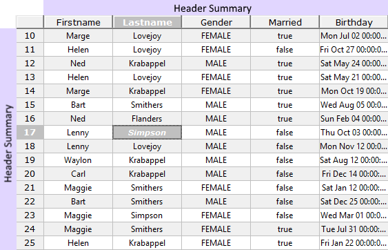

I would like to add a single header for a group of columns and rows.
I've tried using `ColumnGroupHeaderLayer` but the text is in the centre of the column. Instead I would like it to always have the text drawn in the centre of the visible cell and always remain in the same position as I scroll.
I've looked through a lot of documentation but I'm struggling to find anything on how I could do this.
I've attached an example of what I'm aiming for.
Is it possible to achieve this with NatTable?
