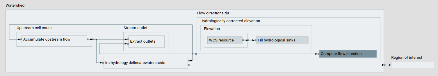

Hi Miro, thank for answer.
Our system build graph on-the-fly.
The server representation of this is a graph and we want to represent it as a dataflow in the web application part.
We use ELK in the server part to layout the graph, then we send the result as ELK JSON to the web application that draw the SVG using sprotty.
We use websocket (with stomp)
We are trying to use the ELK label as complex string (type_of_node.id_of_node for example) to discriminate the different type of node and apply different styles on it. It work but is tricky.
How sprotty-server could help with this?
p.d. I attach a sample (small) of what we generate using sprotty (web part)
In it you can see different color that indicate if the node is waiting, is being processed or is yet calculated.
What we want is the possibility to attach more info (like the type of process or resource) and style them in different way.
[Updated on: Mon, 17 June 2019 08:15] by Moderator
Re: Custom properties on node [message #1808974 is a reply to message #1808095] Fri, 05 July 2019 07:36 Go to previous messageGo to next message
With sprotty-server you can transform your graphs to the sprotty model and use your own subclasses e.g. of SNode etc. to add custom properties. Then the client can render the elements differently depending on those properties.
Re: Custom properties on node [message #1809157 is a reply to message #1808974] Wed, 10 July 2019 06:03 Go to previous message
This is what i'm doing in the client part passing the properties from our server using the label.
We will try to see how to integrate the sprotty-server library.
Thank you very much for help
