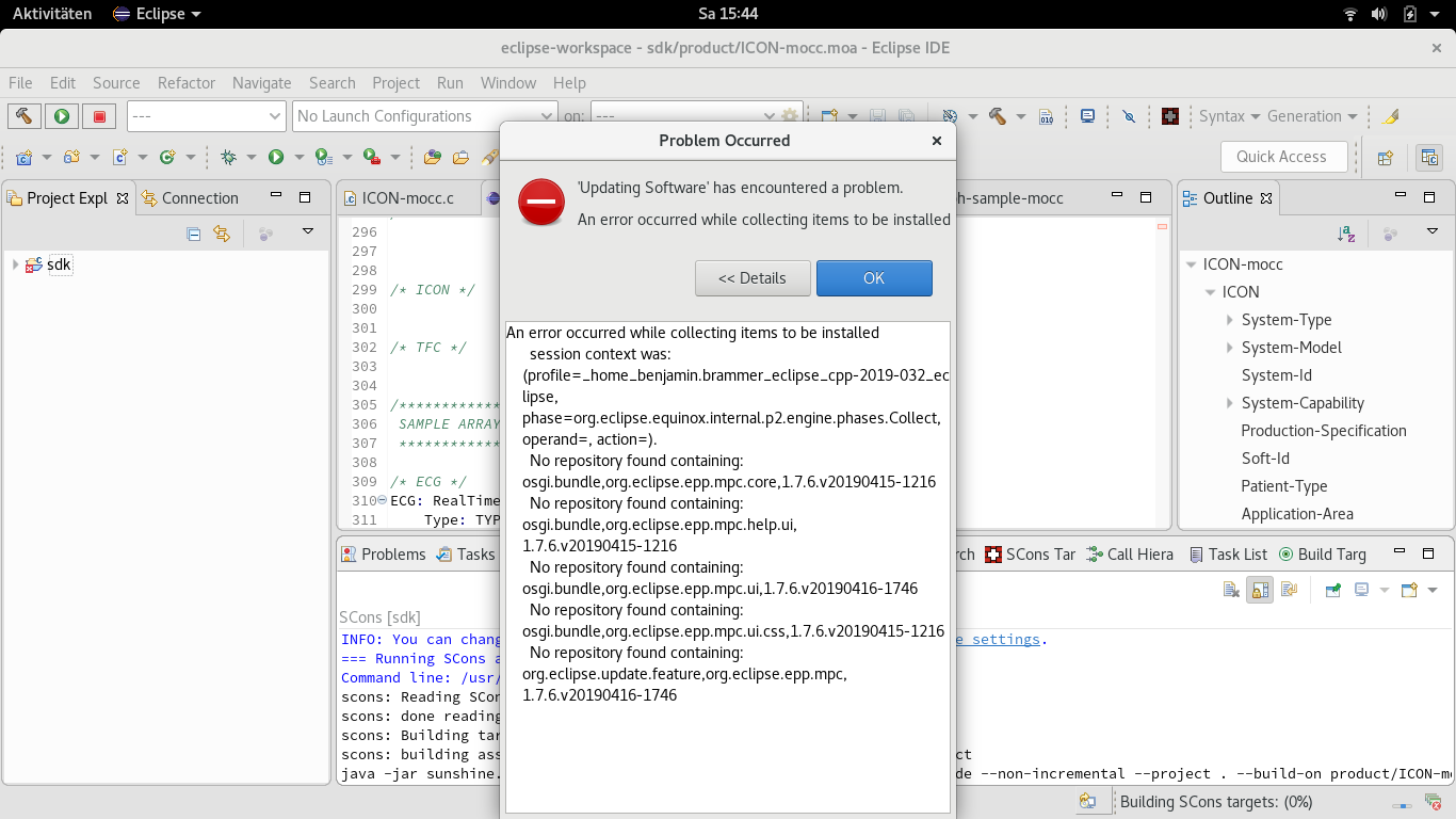

hello guys,
I am very new to eclipse under linux und for a reason I don't understand I cannot update eclipse (original version)
Please see the attached screenshot for details:
An error occurred while collecting items to be installed
session context was:(profile=_home_benjamin.brammer_eclipse_cpp-2019-032_eclipse, phase=org.eclipse.equinox.internal.p2.engine.phases.Collect, operand=, action=).
No repository found containing: osgi.bundle,org.eclipse.epp.mpc.core,1.7.6.v20190415-1216
No repository found containing: osgi.bundle,org.eclipse.epp.mpc.help.ui,1.7.6.v20190415-1216
No repository found containing: osgi.bundle,org.eclipse.epp.mpc.ui,1.7.6.v20190416-1746
No repository found containing: osgi.bundle,org.eclipse.epp.mpc.ui.css,1.7.6.v20190415-1216
No repository found containing: org.eclipse.update.feature,org.eclipse.epp.mpc,1.7.6.v20190416-1746

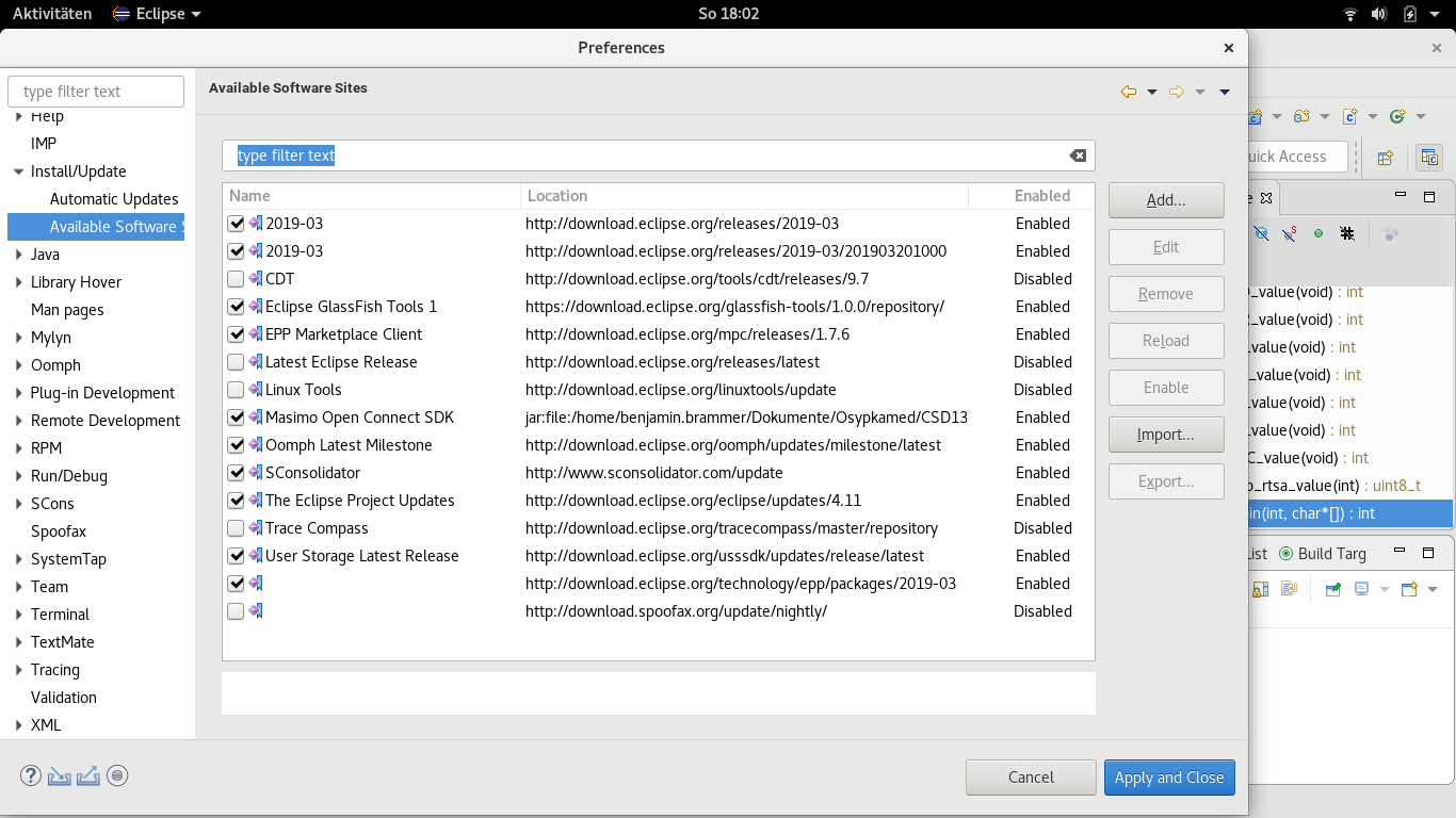

index.php/fa/35667/0/Hello!
I did not try to update anything on my own. Eclipse just reminded me of new available updates. Please find attached a screenshot of my Available software sites tab:
Re: Update of the Eclipse founder's edition not possible [message #1807540 is a reply to message #1807538] Sun, 02 June 2019 13:29 Go to previous messageGo to next message
Trying unchecking the marketplace client site.
Re: Update of the Eclipse founder's edition not possible [message #1807560 is a reply to message #1807540] Mon, 03 June 2019 08:14 Go to previous messageGo to next message
Hey Ed Merks,
it did work :) but why is that the case?
Re: Update of the Eclipse founder's edition not possible [message #1807563 is a reply to message #1807560] Mon, 03 June 2019 11:01 Go to previous messageGo to next message
I don't think the market place client should really be putting it's update site in the list with a site that has updates newer than the release itself. I suspect there's something bogus about their update site or that it has dependencies that can't be installed into the older release. E.g., it would be bogus if the market place client has dependencies on newer bundles and it doesn't also make those bundles available in its update site; it sounds like this is the case, but I'm not really sure.
