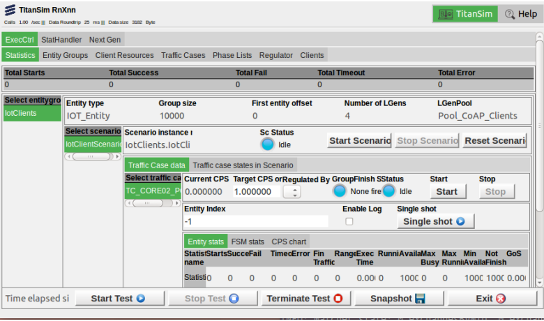

Hi Elemer,
To run performance, which download link should I fetch from ?
- https://projects.eclipse.org/projects/technology.iottestware/downloads
- https://git.eclipse.org/c/titan/titan.Applications.RIoT.git/
And would you know if we can now download an opensource TitanSim performance version for IOT ?
Regards - David

Re: IMS traffic [message #1807577 is a reply to message #1807565] Tue, 04 June 2019 02:42 Go to previous messageGo to next message
Hi David,
IoTTestware, although builds on some of the code published under the Eclipse Titan umbrella, is the project of the German research institute Fraunhofer FOKUS.
so you need to download https://git.eclipse.org/c/titan/titan.Applications.RIoT.git/
and follow the instructions there to assemble the IoT load generator, consisting of
-the core load library
-common GUI
-application libraries for MQTT, CoAP, LWM2M
etc.
Best regards
Elemer
