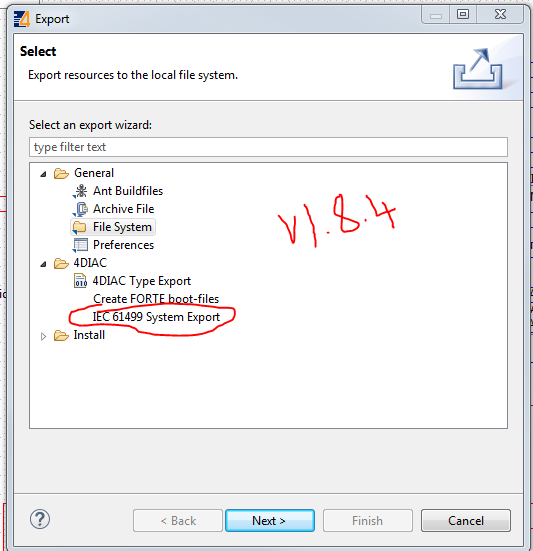

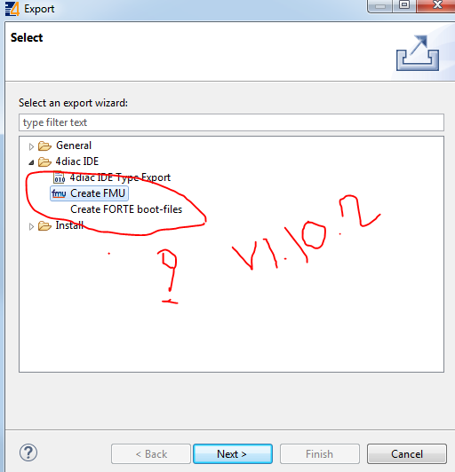

I have created application using 4DAIC v1.8.4 and ther are option to export *.sys file but now I am using v1.10.2 4DAIC IDE and I didn't see any option to create *.sys file
I have tried to get information using the Help and User manual but, unfortunately there is no details on this topic.
pls see attached pic of v1.8.4 and v1.10.2

since 4diac IDE 1.9.0 we changed the storage format. Since then we are storing 4diac projects in .sys files. Therefore the export is not needed anymore as the sys file is already in your project workspace. Also with 1.8.4 we are automatically storing a sys file in your project. This allows you to import 1.8.4 projects into 4diac IDE > 1.9.0.
