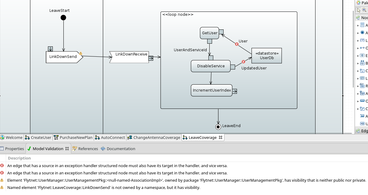

I have an activity diagram that has a loop node. Inside the loop node there are some Object Flows On the Object Flows that go to and from a Data Store Node,
index.php/fa/35623/0/
I'm getting a validation error that says Quote:
An edge that has a source in an exception handler structured node must also have its target in the handler, and vice versa.
What is this telling me? I don't have any exception handler.
Steve
Re: Need clarification on validation error. [message #1807559 is a reply to message #1807142] Mon, 03 June 2019 08:14 Go to previous messageGo to next message
It looks like this is a known bug [1]. It seems that the validation is wrong, you should not take care of the error.
Pauline
1: https://bugs.eclipse.org/bugs/show_bug.cgi?id=503334
