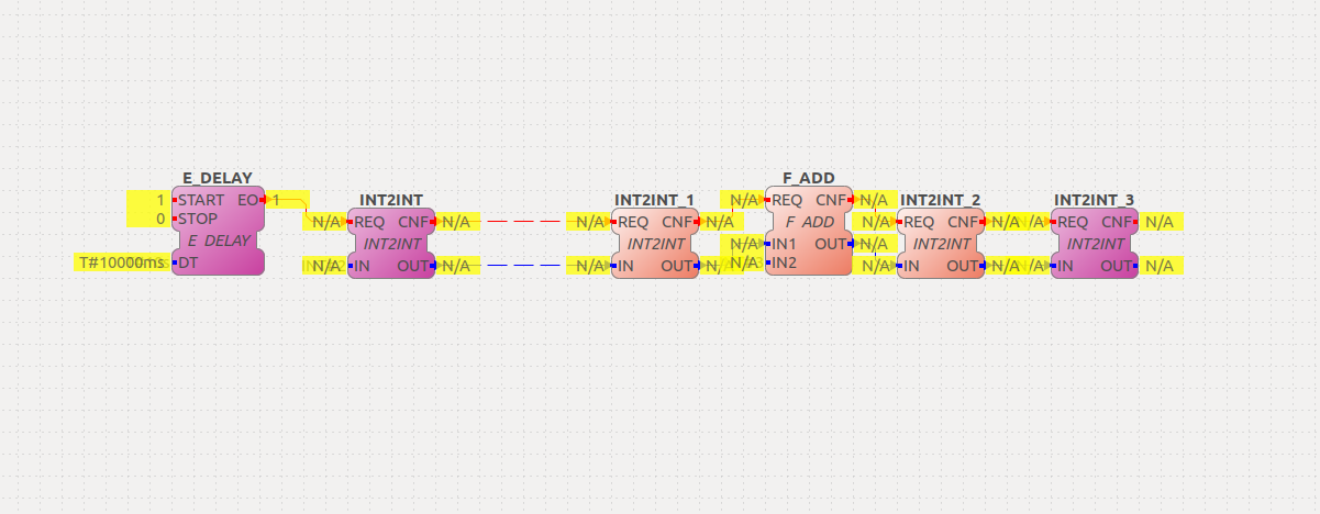

Re: IEC 61850 Sampled Values [message #1807608 is a reply to message #1807368] Tue, 04 June 2019 13:35 Go to previous messageGo to next message
I am currently doing the same, I have removed the codes from existing FORTE code. But, recently when I tried implementing Publish/Subscribe over UDP example as shown in the documentation, I face an error. The the event from the E_Delay block doesn't drive the REQ of INT2INT FB to 1. Please find the image attached for your reference. Could you tell me what I may have done wrong in this?
Karthik
Re: IEC 61850 Sampled Values [message #1807609 is a reply to message #1807608] Tue, 04 June 2019 15:26 Go to previous messageGo to next message
With the information that you gave I would assume that you have a 4diac FORTE without the convert and teh IEC 61131-3 module.
Do you get any error messages in the deployment console?
Re: IEC 61850 Sampled Values [message #1808347 is a reply to message #1807609] Fri, 21 June 2019 15:21 Go to previous messageGo to next message
Dear Alois,
Yes, I had forgot to enable the CONVERT and IEC-61131 modules in forte. It works fine as of now. Thank you.
