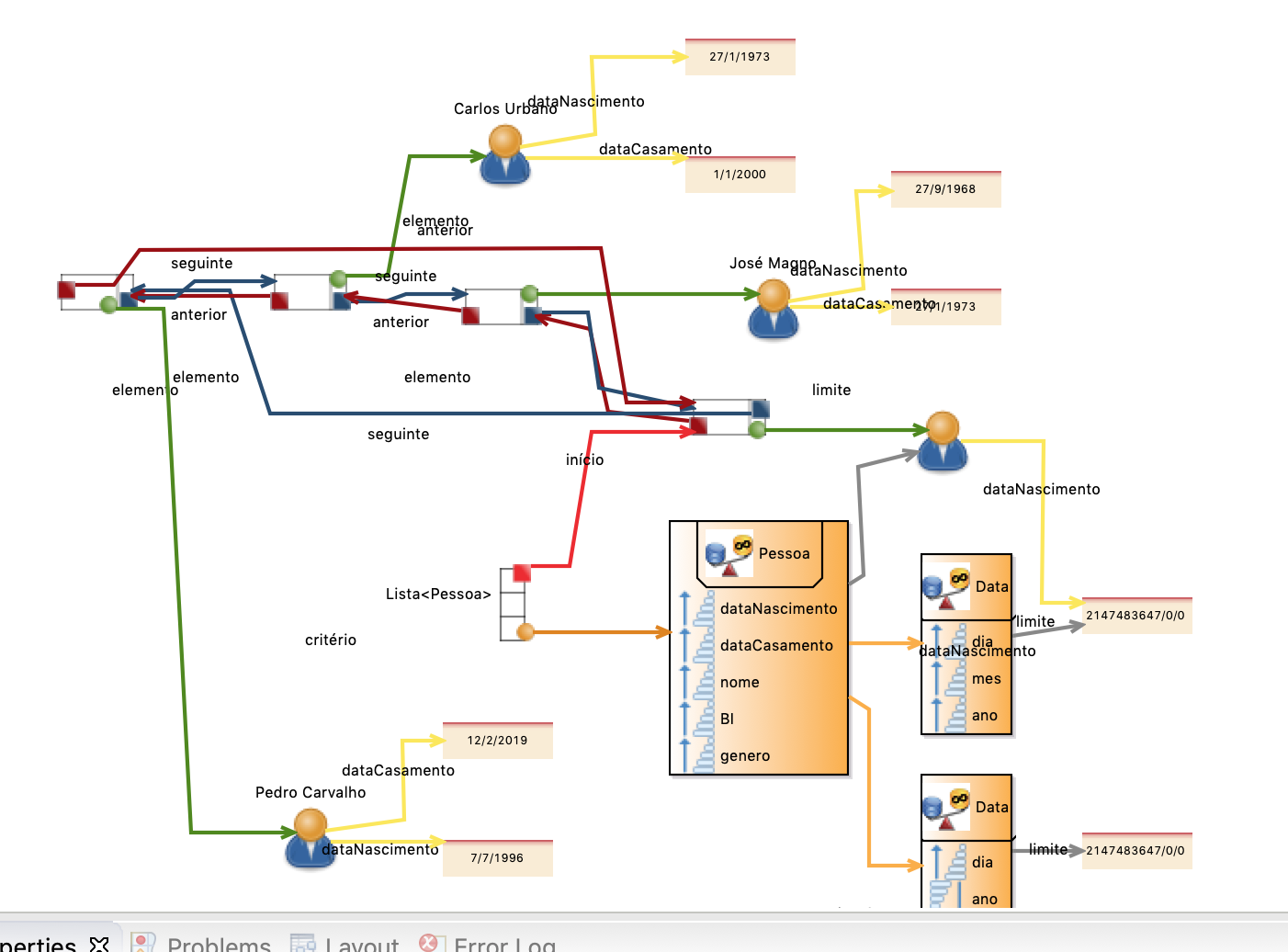

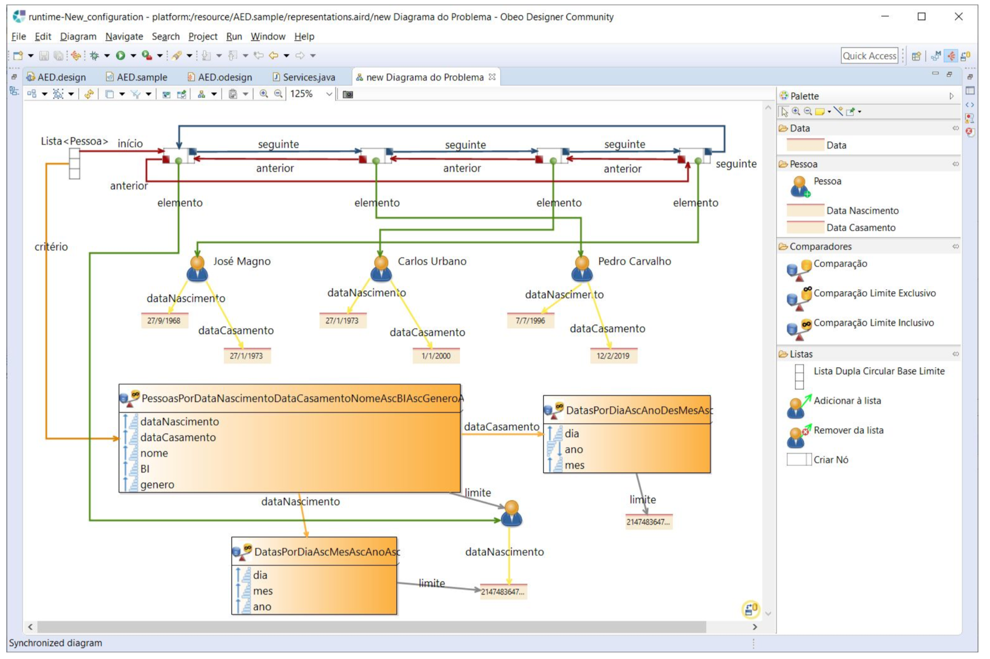

Hello again,
after a lot of research, im still not getting the answer to my problem.
I've got sirius diagram all configured, and I want to get one way to automatically organize my nodes. In attach number 1 is what i'm getting by "arrange all" function, with 1 elk layout algorithm, and i want to get my diagram like the attach 2.
how can i get that solution?

Re: ELK nodes [message #1808306 is a reply to message #1808113] Fri, 21 June 2019 05:35 Go to previous message
I am a little bit confused with what you want.
Layouting is a very complex matter.
You have two solutions:
- Either you use current algorithms available in Sirius and play with available options in odesign by following the documentation to get the optimum result you can have. But its unlikely you will have the perfect result you want.
However there is currently a bug and algorithm options are only applied on top node so their effects are very limited. The bug will be fixed in next version: https://bugs.eclipse.org/bugs/show_bug.cgi?id=547306#
- Or you provide you own layout algorithm to ELK and use it in Sirius odesign. That what I thought you were doing but you currently cannot access semantic element. So you are stuck for now.
