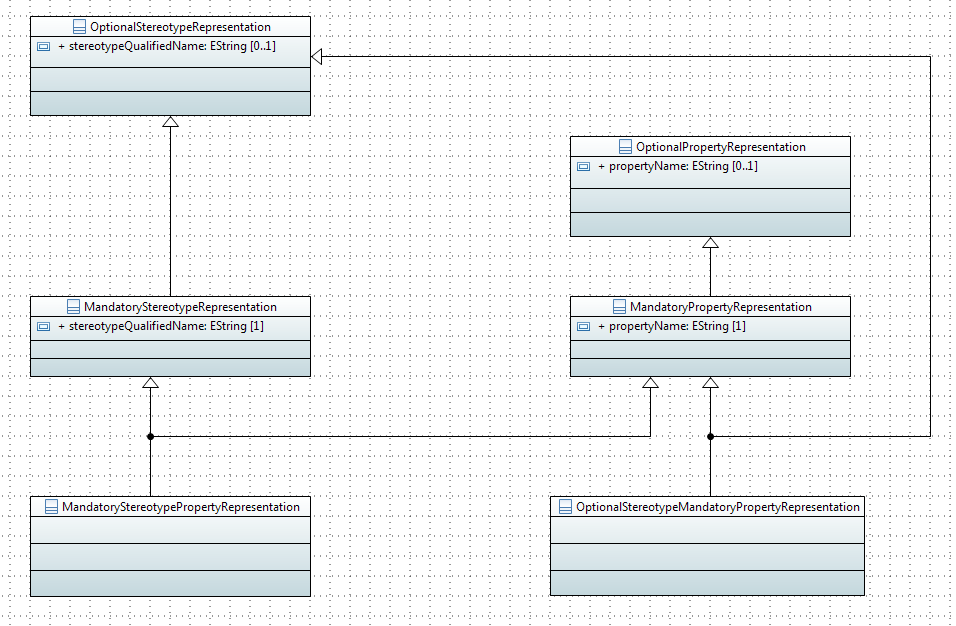

working with UML2Ecore from a Papyrus Class Diagram, I get duplicated @Override on the getter and setter of redefined properties in the generated code (I'm redefining properties in my UML model, just to redefine the multiplicity from 0..1 to 1..1 ).
Is it a know bug ? is there a way to avoid this bad behavior ?
In attachement, a small model close to my real one, allowing to reproduce my bug.
I set Duplicated Feature Inheritance, Duplicated Feature and Redefining Properties to Process in my UML genmodel.

Hi Ed, thank you for your answer. I fill the bug https://bugs.eclipse.org/bugs/show_bug.cgi?id=547424.
I found another workaround to this bug: I add these GenModel EAnnotation to my redefining properties (so the properties of the class Mandatory**Representation in my example).
suppressedGetVisibility -> true
suppressedSetVisibility -> true
It seems me it work find with that.
