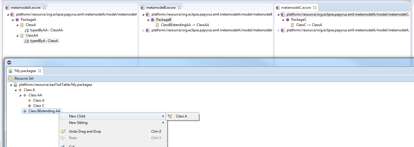

Hi Christian,
this property is already set to true in all my genmodel... In attachment, a simple model to reproduce easily my usecase, with a snapshot of the result.
I'm not able to create a ClassC as children of ClassBExtendingAA (please see snapshot for a better understanding)

Re: limitation of child extender ? [message #1806811 is a reply to message #1806807] Wed, 15 May 2019 09:57 Go to previous message
Another not nice limitation is that the GenModel must know about the other GenModels whose models' child creations it should extend. So if C's GenModel does see B's GenModel (it is not among the usedGenPackages of C), it will not know to create extensions for B.
https://bugs.eclipse.org/bugs/show_bug.cgi?id=274884
