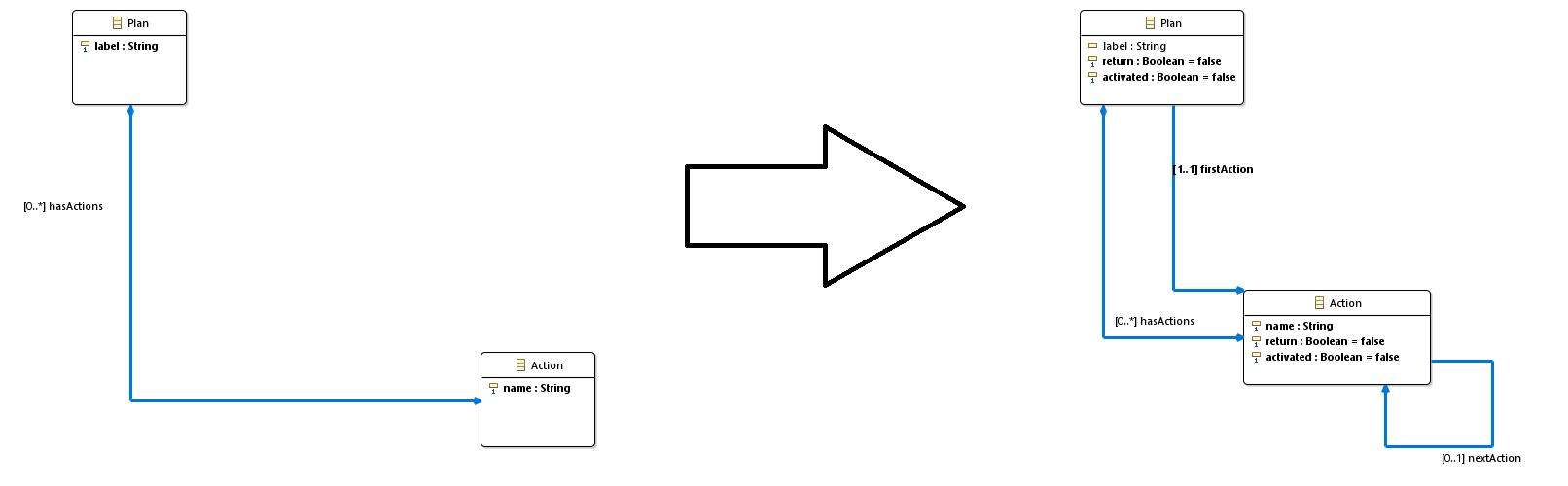

As you can see on the image up here, i want to transform the first pattern (plan and action with just containment relation) to the second pattern (plan and action with containment relation, actions with next reference). But, i couldn't handle to add next references between created actions via rules. I just want to build this next references in natural order which is seen in the source model.
Any help please?

Re: Transforming model elements to model elements with next reference [message #1808727 is a reply to message #1806730] Sun, 30 June 2019 07:09 Go to previous message
You'll want something like this:
rule Plan2Plan {
  from
    s:saml!Plan
  to
    t:masrl!Plan
      label <- s.label,
      hasActions <- s.hasActions,
      firstAction <-
        if s.hasActions->notEmpty() then
          s.hasActions->first()
        else
          OclUndefined
        endif
rule Action2Action {
  from
    s:saml!Action
      not s.refImmediateComposite().oclIsUndefined()
  using {
    actions : Sequence(saml!Action) =
      if s.refImmediateComposite().oclIsUndefined() then
        Sequence{}
      else
        s.refImmediateComposite().hasActions
      endif;
  to
    t:masrl!Action
      name <- s.name,
      nextAction <-
        if actions->includes(s) and actions->indexOf(s) < actions->size() then
          actions->at(actions->indexOf(s) + 1)
        else
          OclUndefined
        endif
