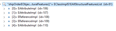

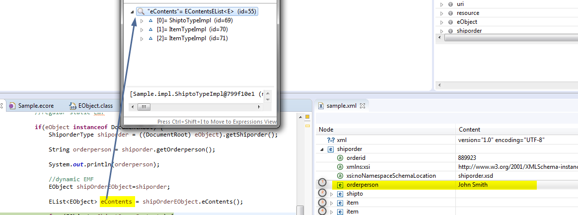

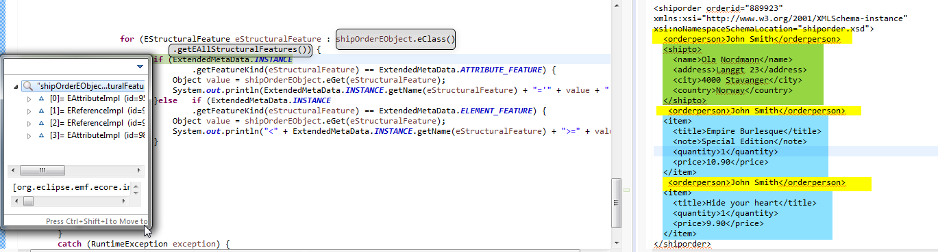

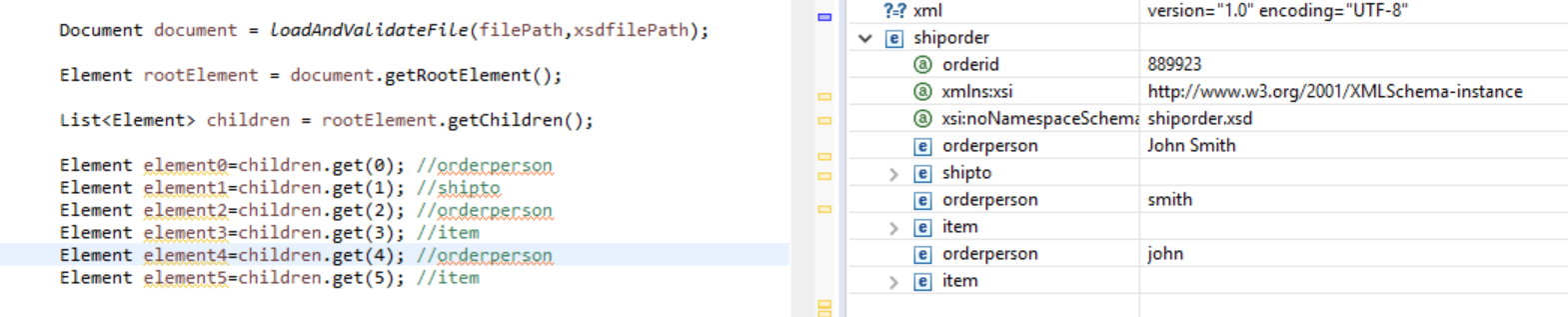

In between I used JDOM2 to check my expectations and this is working as expected (i.e. order of the retrieval of the mixed elements is same as present in the xml)
In case of EMF, still I do not get the right results, as the retrieval is based on EAllStructuralFeatures which will give only unique list and can not handle the scenarios if different XML elements are mixed.
shipOrderEObject.eClass()
.getEAllStructuralFeatures())
Below is the result of execution:
<orderperson>=[John Smith, smith, john]
<shipto>=[Sample.impl.ShiptoTypeImpl@2f9f7dcf (name: Ola Nordmann, address: Langgt 23, city: 4000 Stavanger, country: Norway)]
<item>=[Sample.impl.ItemTypeImpl@747ddf94 (title: Empire Burlesque, note: Special Edition, quantity: 1, price: 10.90), Sample.impl.ItemTypeImpl@1bd4fdd (title: Hide your heart, note: null, quantity: 1, price: 9.90)]
orderid='889923'
