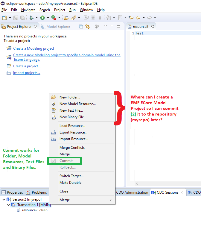

I'm completely new to the Eclipse world, but I want to use Eclispe EMF for modeling and store the models in a CDO repository. I was able to create an Eclipse "ECore Model Project", develop a model there and generate Java code. I now want to add this model to a CDO repository. For this I installed the CDO extension. I also can create a repository and create and edit HelloWorld text files as well as edit and merge them in different branches. However, I don't know how to move or create an ECore model project in a CDO checkout.
Eclipse Version: Eclipse Modelling Tools 2019-03 (4.11.0)
Used Perspectives:
1. Perspective: CDO Explorer (Here I can manage my CDO repository and edit text files, but not create an ECore model project.)
2. Perspective: Modeling (Here I can create an ECore model project but not add it to my CDO checkout or CDO repository.)
More information can be seen on the picture in the attachment (because I can't insert the picture directly here, because I'm a new user in the forum)

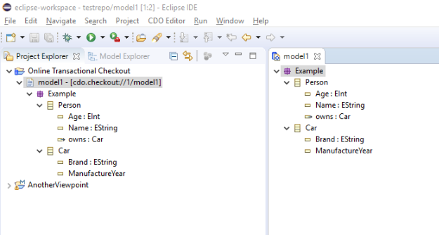

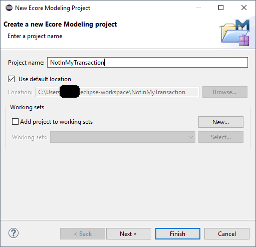

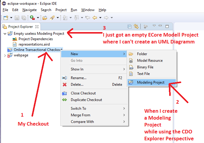

Hello Eike,
do you have any ideas? With the help of File -> New -> ECore Modelling Project I can create a project but it will not be added to my checkout / transaction (picture 1, 2 and 3). On the other hand I have the problem, if I right click on my checkout / transaction, I cannot add an ECore Modelling Project (picture 4).
  • Attachment: 1.png
    (Size: 33.53KB, Downloaded 128 times)
  • Attachment: 2.PNG
    (Size: 21.96KB, Downloaded 115 times)
  • Attachment: 3.png
    (Size: 42.94KB, Downloaded 121 times)
  • Attachment: 4.png
    (Size: 43.57KB, Downloaded 130 times)

Re: How can I add an ECore Modeling Project into my CDO Repository [message #1806840 is a reply to message #1806809] Thu, 16 May 2019 02:39 Go to previous messageGo to next message
I'm on travel, so just in short:
1) Start a repository.
2) Add a repository connection in the "CDO Repositories" view.
3) Create a Checkout and select it in the Project Explorer view.
4) Create a New -> Model Resource under the checkout.
5) Open the resource and add a New Root object to it. Select the Ecore package and then the EPackage class.
6) From there you can populate your new EPackage quite as normal. You don't need an Ecore Modeling project.
Re: How can I add an ECore Modeling Project into my CDO Repository [message #1806942 is a reply to message #1806840] Sat, 18 May 2019 10:40 Go to previous messageGo to next message
Hello Eike,
thank you so much for taking the time for us during your trip! You have already helped us a lot. Personally I would like to work with the Design Viewpoint to manipulate the ECore package. In an ECore modeling project for testing purposes which is not hosted in a CDO repository, I have a .arid file available for this purpose. If I could use this viewpoint, the pair of Eclipse EMF and CDO would be perfect for me. If there's no way to do that, it wouldn't be so bad (if there's a way to open the design viewpoint and I don't use an .arid file, that's fine too).
However, I have been searching for a few hours since yesterday to change the viewpoint to the design viewpoint. Can you help me with that, too? That would be very nice. I don't know how I can thank you.
I have uploaded a screenshot of the latest status to the attachment.
With kind regards
telelolo
[Updated on: Sat, 18 May 2019 10:46] by Moderator
Re: How can I add an ECore Modeling Project into my CDO Repository [message #1807001 is a reply to message #1806942] Tue, 21 May 2019 01:16 Go to previous messageGo to next message
I suppose this "Design Viewpoint" comes from EcoreTools or Sirius, so I can not comment on it. Most likely it's not prepared to use CDO as a persistence layer out of the box. Both technologies are developed by Obeo and I know that Obeo offers a team-enabled version of their Obeo Designer. Have a look at https://www.obeodesigner.com/en/collaborative-features
