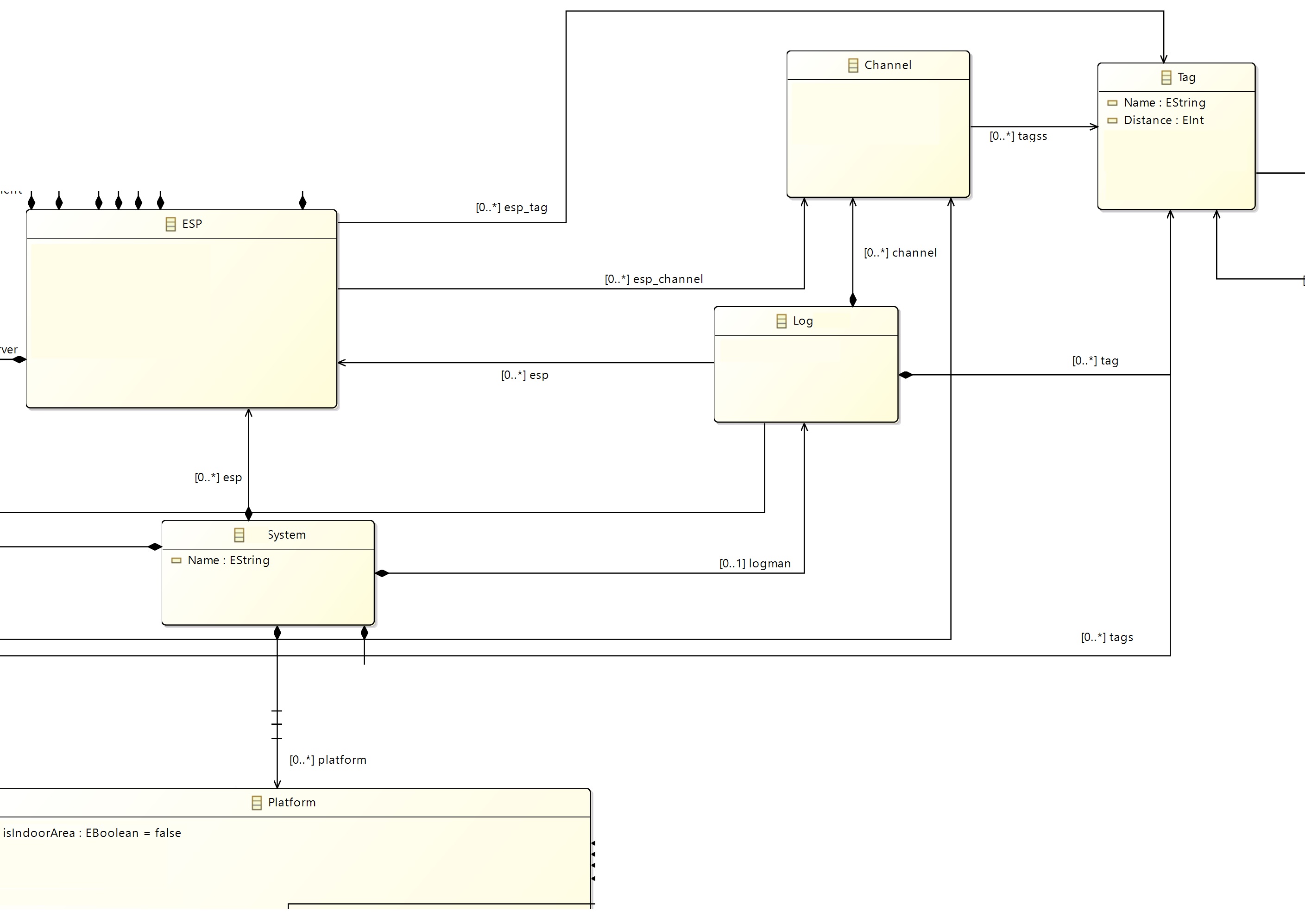

Re: How to access other instances in Sirius while defining semantic constraint ? [message #1806658 is a reply to message #1806648] Mon, 13 May 2019 08:14 Go to previous messageGo to next message
Thanks for your reply. I uploaded my metamodel. I also try to eContent and eContainer, but i could not get it worked. Could you sugget something when you check metamodel?

On the screenshot, the reference betwen System and Platform is multivalued but as I read again your initial message you said that " (by the way only and only if 1 Platform object can exist in the system)". I am not sure if you mean that there can only be only one Platform object in the model. If that the case, from the context of a Tag, to access the Platform, you should have an expression like aql:self.eContainer().eContents()->Filter(Platform) or aql:self.eContainer().oclAsType(System).platform. If you can have multiple Platform then you will need a reference between Tag and Platform otherwise you would not know which Platform element to choose.

Great! Then in your metamodel you can change the multiplicity of the reference platform between System and Platform to [0..1] and eventually add a validation rule checking that a Platform has been set.
