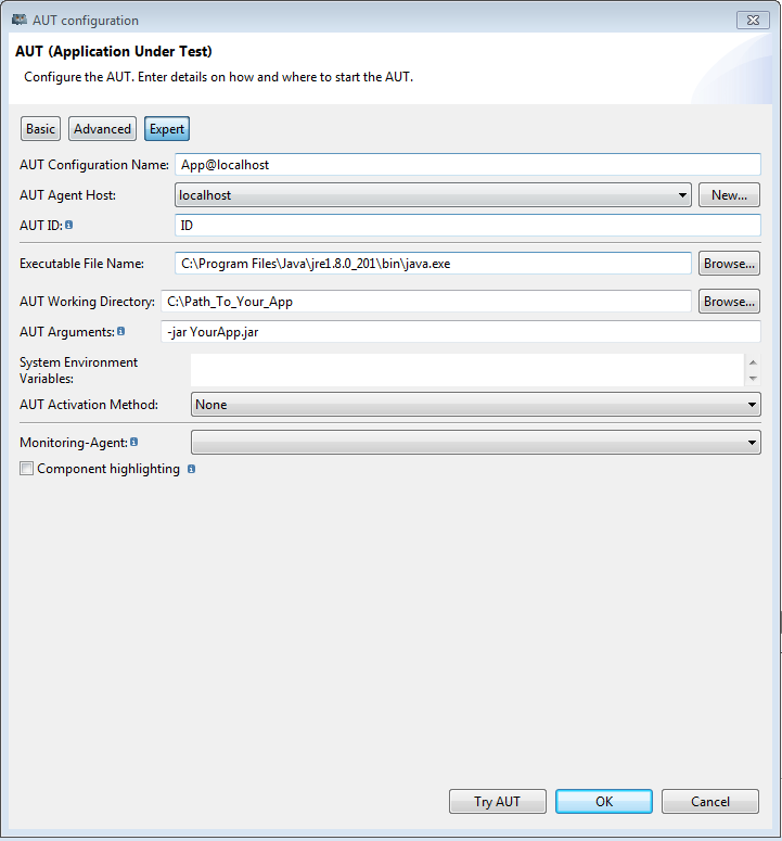

Hello Mike,
In the AUT configutration try these configurations:
Executable File Name: C:\Program Files\jre1.8.0_201\bin\java.exe (path to your java environement \bin\java.exe)
AUT Working Directory: C:\path_to_your_app
AUT Arguments: -jar YourApp.jar
index.php/fa/35522/0/
best regards
Nizar Tenzekhti

Re: AUT stuck 'in progress' [message #1806535 is a reply to message #1806453] Fri, 10 May 2019 05:02 Go to previous messageGo to next message
Thanks Nizar, these are the parameters I am using. The issue is not that the app isn't starting. The problem is that Jubula is not being notified that it has started and thus is not registering the AUT as running. This means that Jubula will not allow me to do the Object Mapping.
