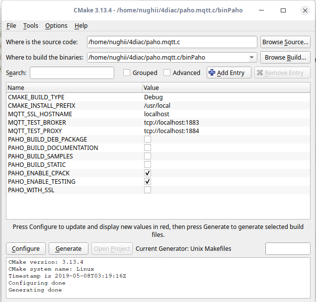

How do I ensure that I already have an MQTT broker on localhost?
This is my CMake screenshoot
index.php/fa/35509/0/

Re: MQTT Implementation in 4diac [message #1806367 is a reply to message #1806344] Wed, 08 May 2019 04:15 Go to previous messageGo to next message
The MQTT broker setting are for the demo programs, and are not relevant for FORTE.
Your compile error teills you, that MQTTAsync.h from the Paho MQTT cannot be found, so you should check your FORTE settings for the location of Paho

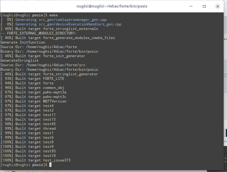

Re: MQTT Implementation in 4diac [message #1806448 is a reply to message #1806371] Thu, 09 May 2019 05:09 Go to previous messageGo to next message
Ok, I have checked the location of Paho on FORTE and now there is no error.

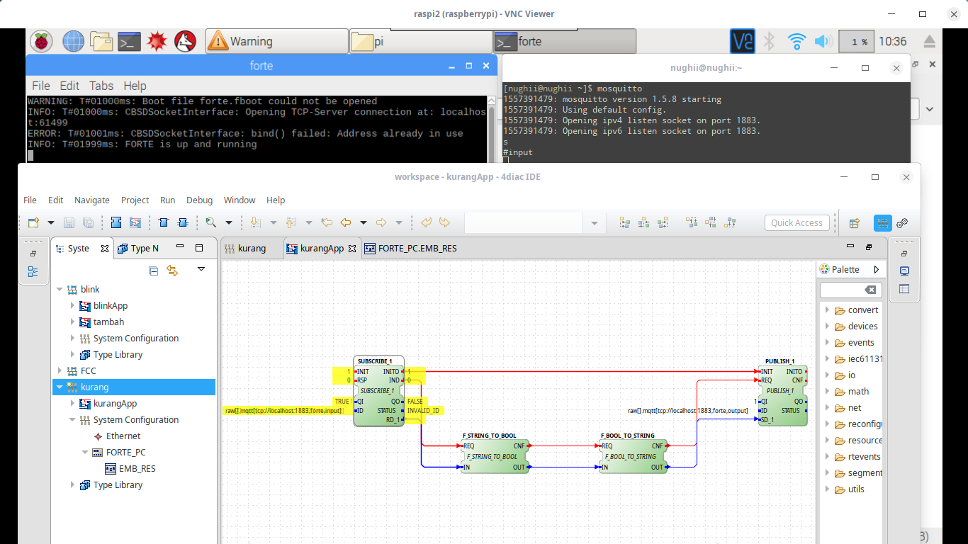

Then I tried another method based on my understanding of your answer:
1. I installed and ran mosquitto on my laptop as a broker.
2. I am doing 4diac FORTE mapping to raspberry pi.
However, why is there still an error?
index.php/fa/35520/0/
[Updated on: Thu, 09 May 2019 05:17] by Moderator
Re: MQTT Implementation in 4diac [message #1806450 is a reply to message #1806448] Thu, 09 May 2019 05:19 Go to previous messageGo to next message
I think if your application is running on the raspberry pi and your broker on your laptop then the address given in the Id parameter of your FBs has to be the address of your laptop where the broker is running.

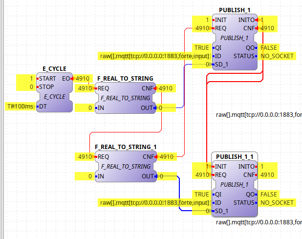

Now, I tried another case. I encountered an error like the following.
index.php/fa/35528/0/
How to deal with it?
  • Attachment: soket.png
    (Size: 77.35KB, Downloaded 1160 times)
Re: MQTT Implementation in 4diac [message #1806489 is a reply to message #1806483] Thu, 09 May 2019 14:52 Go to previous messageGo to next message
0.0.0.0 is not a valid ip address. You need the ip address from which your broker is reachable from your raspberry pi. On windows machines you can find that by typing ipconfig /all in a console and look for the correct interface. Also both have to be in the same network and reachable from each other. But I assume that you have that as you are able to download from your laptop to your raspberry pi.
