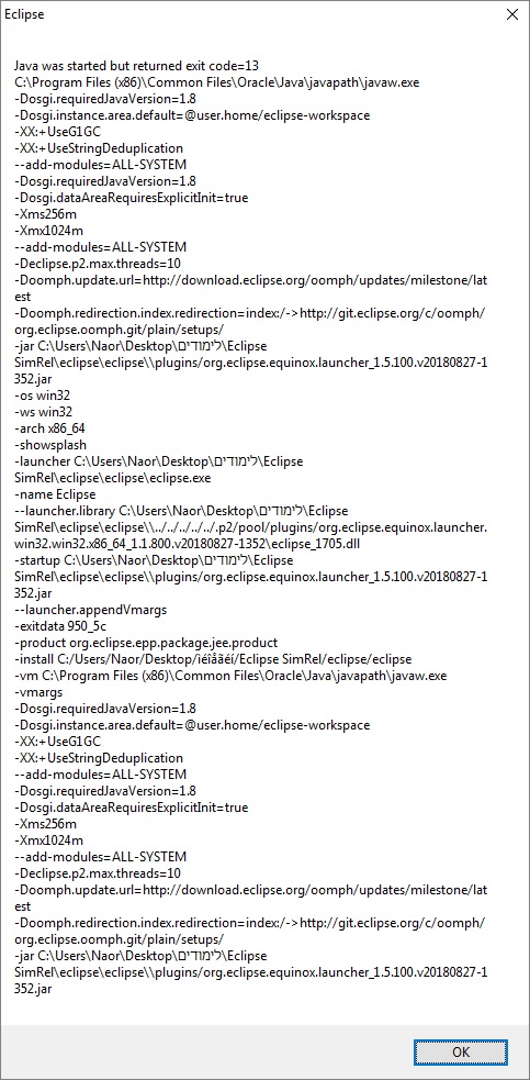

When I'm trying to open eclipse I'm getting this error in the image, and the eclipse won't open at all.
I figured out I could open eclipse tho if I run the jar file in eclipse/plugins folder
called:
org.eclipse.equinox.launcher_1.5.100.v20180827-1352.jar
for some reason it would pop up the normal work-space message and eclipse would run without any error...
I'm just confused why the original eclipse launcher not working if some1
could provide quick fix.
thanks!
  • Attachment: Untitled.jpg
    (Size: 190.80KB, Downloaded 358 times)
Re: Error opening eclipse [message #1806168 is a reply to message #1806164] Sat, 04 May 2019 12:04 Go to previous message
You're trying to run a 64 bit installation with a 32 bit version of Java.
