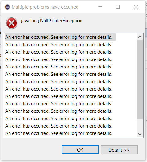

I'm testing Papyrus Compare. I would use it for collaborative work.
I configured it using this page and I followed the tutorial video provided as reference.
Unfortunately, when I'm trying to check out on another branch, I obtain multiple Null Pointer Exception and furthermore they are launched each time I click on a diagram. Is it a known bug?
I join a snapshot and the log of this exceptions.
I precise that I use the last nightly build of Papyrus (4.4) and the stable version of Papyrus Compare.
Moreover, I would like to know if there is a recent documentation about Papyrus Compare? Some summary of best practices? I would also appreciate some feedback by users if possible. Thank you.

  • Attachment: ErrorBox.PNG
    (Size: 33.58KB, Downloaded 134 times)

Re: Multiple Null Pointer Exception Papyrus Compare [message #1824113 is a reply to message #1823888] Wed, 08 April 2020 02:36 Go to previous messageGo to next message
Hi Yoann,
the NullPointerException that you've posted doesn't come from Papyrus Compare. When you switch branches, Git changes the files on disk to the state of the other branch to which you are switching.
The actual reason for the NullPointerException seems to be a failed Cut operation (as in Copy, Cut and Paste). It does not seem related to Papyrus Compare or switching branches.
