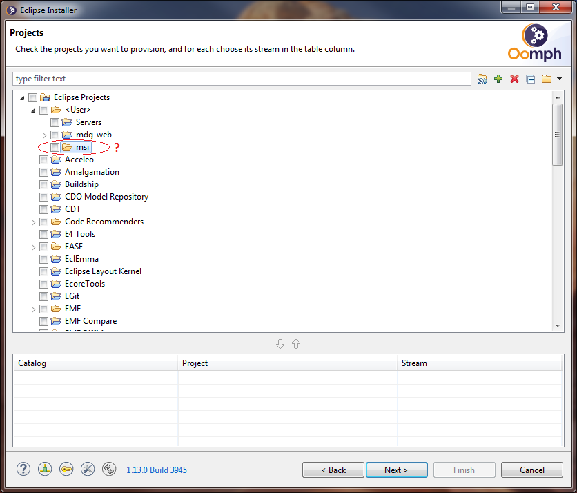

I'm trying to author a project model setup for an eclipse project : a simple maven java project called msi
But when I try to install a new eclipse instance including this msi project, I can't select it on the wizard. (see snapshot in attachement)
Msi project appears, but the corresponfing icon looks very simple without any decorator. And most of all, I can't select it...
My setup file is attached to this post

Your Project does not specify any Streams. Only Streams can actually be selected in the wizard. A Project without Streams is only useful if it contains sub-Projects. The decoration you see in the wizard (and the editor) reflects this fact: the blue folder icon is used for a Project with at least one Stream while the yellow folder icon is used for a Project without Streams.
