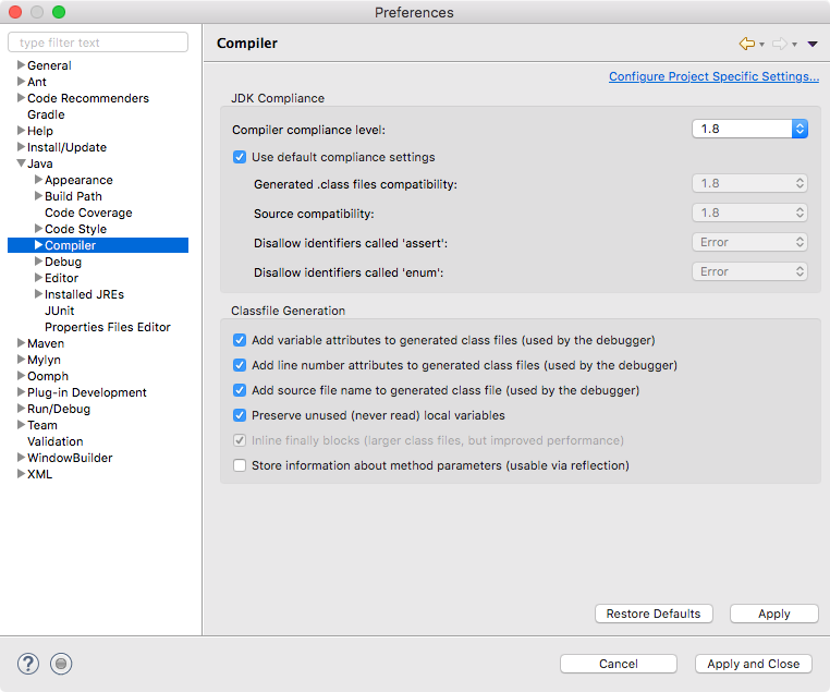

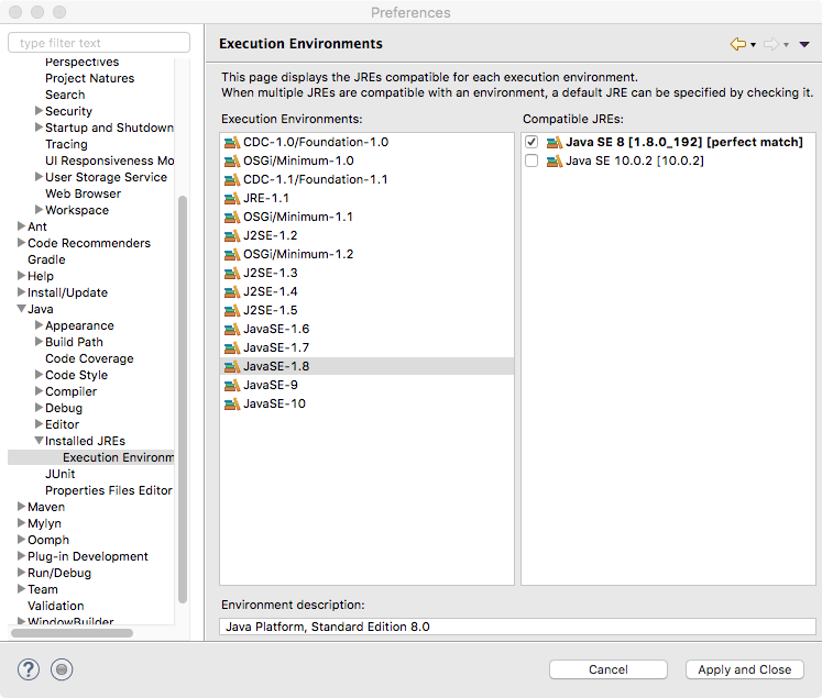

index.php/fa/35453/0/index.php/fa/35452/0/I've redone the setup for Java on my HP running Windows 10 very many times, and nothing has changed the error message: "A JNI error has occurred, please check your installation and try again." I'm not sure what "your installation" refers to. Presumably it is Java JDK and/or JRE and how they are configured on the Windows unit.
Originally, my Mac was running Java 10. I suspected that was the problem, so I uninstalled it and installed the vanilla Java 8. I have made sure that in Preferences "Compiler compliance level" is set to 1.8, and Execution Environments is set for Java SE 8(1.8.0_192 labeled by Eclipse as a "perfect match."
The JAR that I"ve made for my project works on my regular Mac and an older unit that is semi-retired and has a different OS. I had been moving the JAR from computer to computer view my website, but I just tried making a ZIP containing the JAR and support files. That attempt also failed.
I also took an old project made a year or so ago and borrowed its source files, etc. to make a new project on the new Mac. It worked, and I made a JAR for it. That JAR was successful on the HP computer.
I will add two screen shots showing how the new Mac's Eclipse is set up. I need some way to do a better job of troubleshooting.
