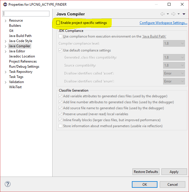

I'm having troubles with an inherited huge project with the workspace settings.
No project is taking into account any workspace setting. The first thing I thought was that the project are using specific project settings (which would overtake the workspace ones), but it's not the case!
See the following screenshot:
index.php/fa/35426/0/
I find myself going through every enabling the project specific settings individually (which is a time consuming task).
There's should be a config error in my eclipse, but I can't find it!
Does anybody know why this is happening?
Thanks in advance,
Joaquin
Re: Project doesn't use the Workspace Settings [message #1806004 is a reply to message #1805995] Tue, 30 April 2019 06:42 Go to previous message
These settings are stored in each project under the project's hidden .settings folder. Perhaps someone has not committed those to the source code repository? For all my projects, works properly, but of course they are committed to the Git repository as well, otherwise they would be lost...
