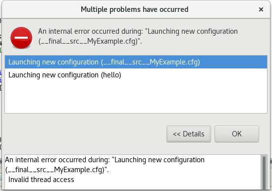

I have a error when I make Run Configuration (TITAN Parallel launcher) like picture below. I configured follow to your document but not work.
Could you help me to fix it?

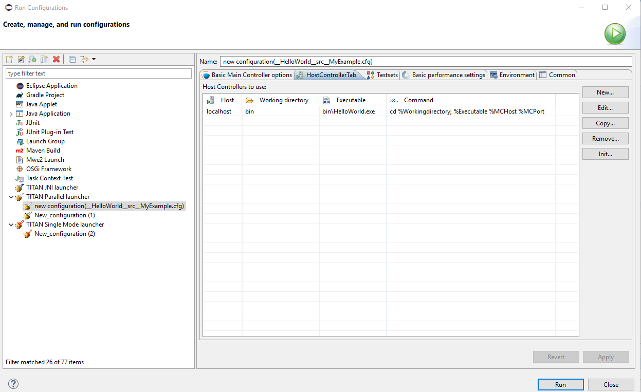

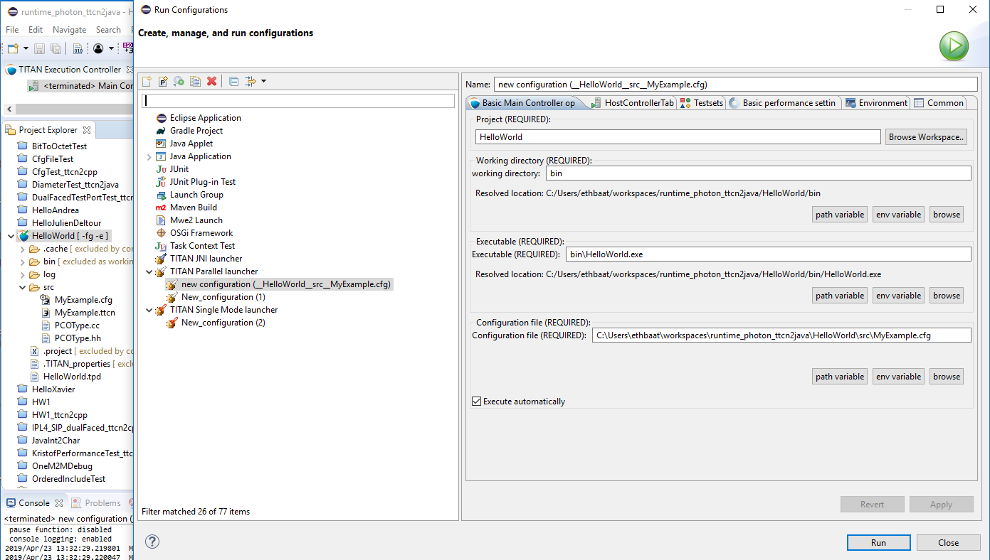

2. I simple show the details of run config of the simple project "HelloWorld" generated by Eclipse Titan itself. If I start a run configuration, this dialog appears:
index.php/fa/35387/0/ (Capture01.png)
As you can see if the name of the project is "HelloWorld" and the name of the cfg file is src/MyExample.cfg then the name of the configuration will be "new configuration (__HelloWorld__src__MyExample.cfg)". You can modify it, if you want.
On the Host Controller tab you can see something like this (Capture02.png):
index.php/fa/35388/0/
If you removed it somehow, just push "Init..." or "New..." and you can modify it
The other tabs are not important at first but you can get info from ExecutorUserGuide.pdf (Chapter 4 and 5).

Your first picture (Capture.png) is interesting: as if two configuration were started at the same time. The first cfg is __final__src__MyExample__cfg (Project name: final, cfg file name src/MyExample.cfg) and the second configuration is "hello" (modified manually). I have no idea (yet), how this two project get into a conflict.
Jeno
