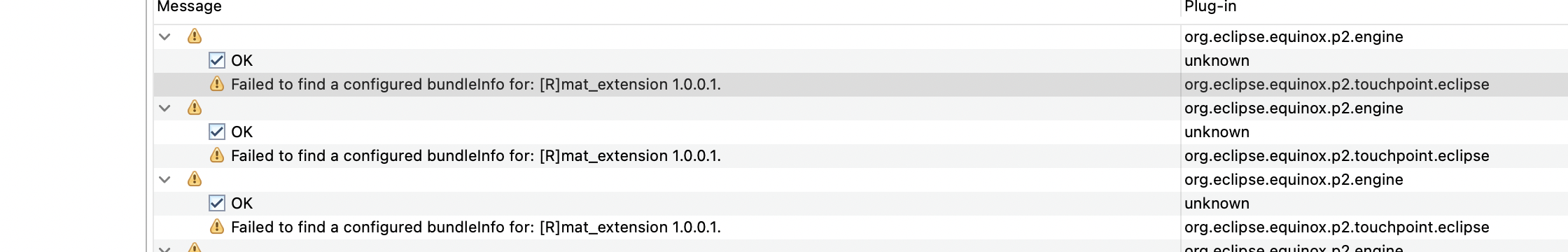

Re: TFS Plugin on OSX [message #1859877 is a reply to message #1805609] Mon, 03 July 2023 10:19 Go to previous message
Have you got any solution regarding your problem? I am having a similar error while installing a custom made plugin to eclipse MAT.
Error:
org.eclipse.equinox.p2.touchpoint.eclipse
Warning
Failed to find a configured bundleInfo for: [R]<Plugin_Name>
