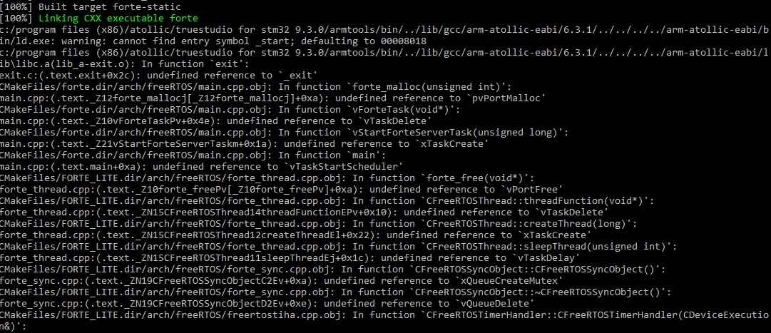

Firstly I congratulation for you delevloped 4diac, open source runtime and plc programming ide.
I use STM32F746 discovery kit which includes ethernet. Also I did run freeRTOS and lwip on STM32F76 board.
I try to compile 4diac for freertos+lwip until now I did not success. Some errors like this:
"[100%] Linking CXX executable forte"
exit.c:(.text.exit+0x2c): undefined reference to `_exit'
CMakeFiles/forte.dir/arch/freeRTOS/main.cpp.obj: In function `forte_malloc(unsigned int)':
main.cpp:(.text._Z12forte_mallocj[_Z12forte_mallocj]+0xa): undefined reference to `pvPortMalloc'
undefined reference to `vTaskDelete'
undefined reference to `xTaskCreate'
.... etc.
I want to ask you officially support freeRTOS? can I compile forte for freertos+lwip (for stm32) or freeRTOS upcoming?

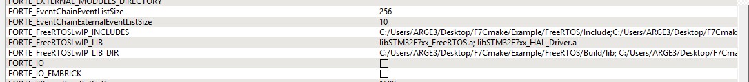

thanks for reply. If I success to compile 4diac for stm32f7 I want to share with you, my illustrations.
I have little experince for cmake how to compile thats why I dont know how to define platform specific symbols.
I had earlier compiled freertos project for stm32f746 which includes "libSTM32F7xx_FreeRTOS.a" , "libSTM32F7xx_HAL_Driver.a".
This project's CMakelists.txt
# Load the the extern library
add_library (STM32F7xx_HAL_Driver STATIC IMPORTED)
set_property (TARGET STM32F7xx_HAL_Driver PROPERTY IMPORTED_LOCATION ${CMAKE_SOURCE_DIR}/Drivers/Build/lib/libSTM32F7xx_HAL_Driver.a)
# Load the the extern freertos library
add_library (STM32F7xx_FreeRTOS STATIC IMPORTED)
set_property (TARGET STM32F7xx_FreeRTOS PROPERTY IMPORTED_LOCATION ${CMAKE_SOURCE_DIR}/FreeRTOS/Build/lib/libSTM32F7xx_FreeRTOS.a)
In summary, how can I define FORTE_FreeRTOSLwIP_LIB? Which extension need to be this file?(".a" , "lib" ) I tried "libSTM32F7xx_FreeRTOS.a" but any results.
Thanks.
Re: About FreeRTOS [message #1805659 is a reply to message #1805643] Fri, 19 April 2019 13:49 Go to previous messageGo to next message
maybe you then need more then one lib. In CMake Gui you can find, when selecting the advanced option, CMAKE_EXE_LINKER_FLAGS. There you can specify any option specific for you platform so in your case you could give "-lSTM32F7xx_FreeRTOS -lSTM32F7xx_HAL_Driver", where "-l stands for lowercase L". The font in this forum is not very good.
Furthermore you may need more compiler flags. This depends you your toolchain and your platform. you can yuse the CMake options for CXX_flags, Cpp flags to give this to our toolchain. We can unfortunately do this in a generic way. The best is that you take your example applications as reference.
Also please note that everytime when you make changes to your Cmake config you need to run configure and generate bevore you can run make again.
I hope this helps you to get this quickly runnig.
Cheers,
Alois
Re: About FreeRTOS [message #1805795 is a reply to message #1805659] Wed, 24 April 2019 04:35 Go to previous messageGo to next message
I compiled forte for freeRTOS susscessfully. The easiest way I found was to compile forte as a library. Usually you have a project in some IDE for your board, where you have all the files for compiling a normal freeRTOS application.
The important thing is to select "FreeRTOSLwIP" as FORTE_ARCHITECTURE, add all the folders with headers files from your project to the variable FORTE_FreeRTOSLwIP_INCLUDES (separated by semicolon) and keep FORTE_BUILD_STATIC_LIBRARY true and FORTE_BUILD_EXECUTABLE false.

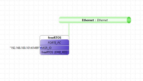

  RMT_DEV *poDev = new RMT_DEV;
  poDev->setMGR_ID("192.168.100.101:61499");
  poDev->startDevice();
  DEVLOG_INFO("FORTE is up and running\n");

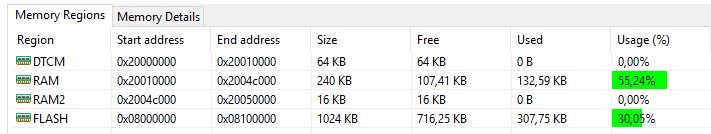

How much RAM have you available on your system. lwIP needs already quite a lot. This can be a problem with 4diac FORTE. Also on some systems I experienced that the tasks created by FORTE need a bit more stack size. Not sure what Jose's experience is here. Also 4diac FORTE will on startup create at least one socket. So lwIP needs to be up and running.
These are some of my experiences when working on very small embedded systems with 4diac FORTE. I hope they help.
Re: About FreeRTOS [message #1806206 is a reply to message #1806054] Mon, 06 May 2019 04:47 Go to previous messageGo to next message
Yes, I got running cleary in a Stm32 and also in a NXP .
As Alois said, you should start your LwIP first. After I check that the LwIP didn't fail, I start my forte task:
    if(sys_thread_new("forte_thread", forte_thread, NULL, 2000, 4) == NULL)
    	 LWIP_ASSERT("forte_thread(): Task creation failed.", 0);
the 2000 is the stack size. I'm not sure about it, but I think the stack later multiplies by 4 somewhere. Anyhow, I'd recommend to add:
void vApplicationMallocFailedHook(){
	for(;;){
		vTaskDelay(pdMS_TO_TICKS(1000));
void vApplicationStackOverflowHook( TaskHandle_t xTask, char *pcTaskName ){
	for(;;){
put a breakpoint in both vTaskDelay, and in FreeRTOSConfig.h file make sure you have:
#define configCHECK_FOR_STACK_OVERFLOW 1
#define configUSE_MALLOC_FAILED_HOOK 1
This will allow you to check if there's a problem with your memory size. If the breakpoints above are reached, your memory is too small

As you said, I debugged and watched my memory (heap) with vApplicationMallocFailedHook function. I saw my memory which I allocated heap is not enough. When forte define object (RMT_DEV *device = new RMT_DEV;) the microcontroller(STM32F7) make malloc failed.
I incrased my allocated heap there are no problems in there.

I compiled forte as a static library and included my STM32 freertos lwip project.
Here is my project details.
Memory map, linker file, FreeRTOSConfig.h
#define IPTASK_HEAPSIZE 128
#define FORTETASK_HEAPSIZE 20000
[Updated on: Tue, 17 September 2019 07:52] by Moderator

Now I have a new problem, I cant deploy any 4diac application to my board.
The problem is : Major download error Problem: Create Resource Instance "xxx" failed.
Added screenshots.
Re: About FreeRTOS [message #1815022 is a reply to message #1815011] Tue, 24 September 2019 06:19 Go to previous messageGo to next message
What did you change so forte could run? are you sure forte is running?
One question: is the FORTE_COM_ETH enabled when you compile forte?
I\''m not sure what the problem could be. I attached my FreeRTOSConfig.h file so you can compare with yours. Check the variables related to the priorities, this might be cause some problems
It's also strange that it crashes when you kill the vIPtask. Can you send the file where your main function is and the vIPTask is created?
Re: About FreeRTOS [message #1815050 is a reply to message #1815022] Tue, 24 September 2019 14:36 Go to previous messageGo to next message
The response to the query commend shown in the deployment console looks a bit suspicious to me. What 4diac FORTE version are you using.

-ffunction-sections -fdata-sections -fstack-usage -Wall -DLWIP_TIMEVAL_PRIVATE=0 -fno-threadsafe-statics -fno-rtti -fno-exceptions -fomit-frame-pointer -mabi=aapcs -fno-unroll-loops -ffast-math -ftree-vectorize -DNOLOG -DFORTE_LITTLE_ENDIAN -DDEV_MGR -DFORTE_SUPPORT_ARRAYS -DFORTE_SUPPORT_BOOT_FILE -DFORTE_SUPPORT_CUSTOM_SERIALIZABLE_DATATYPES -DFORTE_SUPPORT_QUERY_CMD -DFORTE_MODIFY_SOURCES_ON_MISSING_GENERATED_INCLUDES -DFORTE_LINKED_STRINGDICT -DFORTE_COM_RAW -DFORTE_SUPPORT_MONITORING -DFORTE_COM_LOCAL -DFORTE_COM_FBDK -DFORTE_UNICODE_SUPPORT -DFORTE_USE_64BIT_DATATYPES -DFORTE_USE_REAL_DATATYPE -DFORTE_USE_LREAL_DATATYPE -DFORTE_USE_TEST_CONFIG_IN_FORTE -DFORTE_USE_WSTRING_DATATYPE -D__USE_W32_SOCKETS
C++ Linker / Miscellaneous flags as the same.
