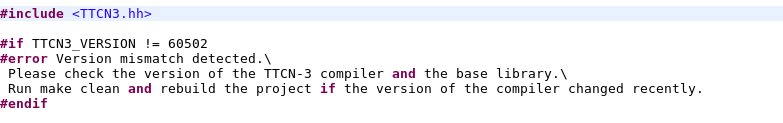

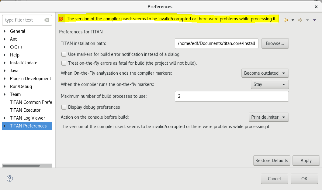

Hello everyone,
I tried to installing Titan based on Readme file of source below
https://github.com/eclipse/titan.core. However, I have many problem due to TTCN-3 version , Makefile.personal, Clang version ...
Could you show me your base processing for installing titan on Debian/Linux ?
Thank you very much,
DUY.

A new requirement is to have teh Eclipse plug-in version and the titan core version in sync (that i s, if you have a titan core 6.5.1, you will need Eclipse plug-ins of version 6.5.1).;
the fault displayed indicates that this might be the problem with your installation.

on web of eclipse, there is Eclipse plug-ins version 6.5.0. But on github, binaries is version 6.5.2. I was complex among 2 differences versions. Actually I must be downgrade my eclipse titan version. Now it works well.
