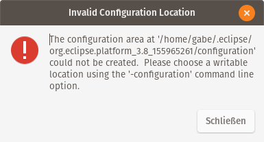

1. Option: Pop_OS! Package installer. The installation does run through, but after the first startup I get the following error message:
The configuration area at '/home/gabe/.eclipse/org.eclipse.platform_3.8_155965261/configuration' could not be created. Please choose a writable location using the '-configuration' command line option.
I did change my ownership on my home folder, but this also didn't work. The Folder itself hasn't been created yet.

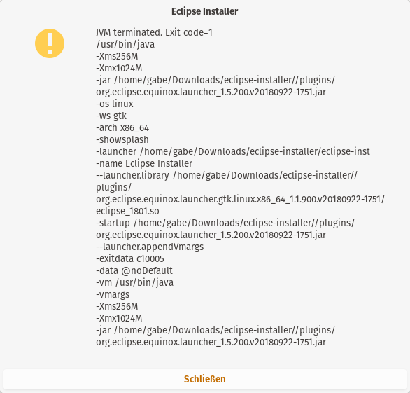

2. Option: Installing it manually with the Tar-File from the website. When I start the installer I get the 2 Error Messages:
index.php/fa/35321/0/
and another error message which I can't show you directly, because the page doesn't allow me to:
imgur dot com gnTttTq
What can I do to solve this issue?

Re: Can't install Eclipse on Ubuntu [message #1805410 is a reply to message #1805408] Sun, 14 April 2019 11:40 Go to previous message
I wonder what version of Java you have in /user/bin/java?
You're issue sounds a bit like this:
https://www.eclipse.org/forums/index.php/t/1094550/
Also like this:
https://stackoverflow.com/questions/4861380/jvm-terminated-exit-code-1
You should make sure you have at least Java 8 installed and it should be a 64 bit version. This Java should be what's on your PATH. I.e., if you enter "which java" it should be a 64 bit Java 8; the installer will use what's on your PATH and will create an installation that uses this version of Java.
