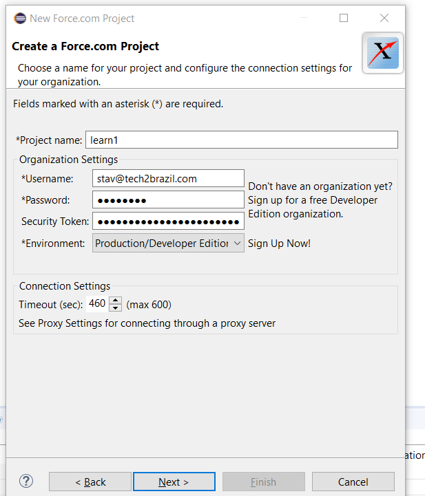

When Icreate a new force.com project I cannot go through the first step.
After filling out the project details , token and credentials - The NEXT button doesn't do any thing,
