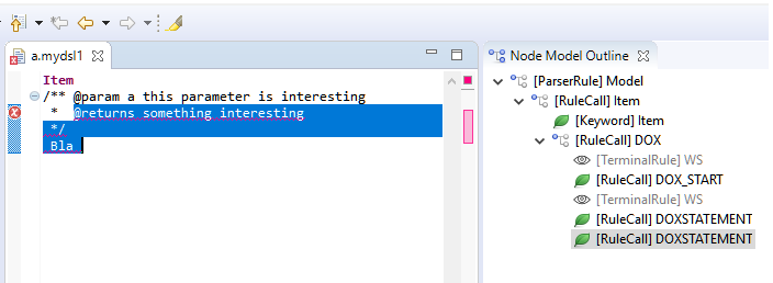

2. Another smaller detail is that in the referenced post, the language allows to identify "end of unquoted text" by detecting a newline. In doxygen, I need to detect "*/". That seems to cause problems in the parsing process as well.
Works OK, but is a bit wrong:
DOX: DOX_START
stmts+=DOXSTATEMENT+
DOX_END
terminal DOX_START: '/**';
terminal DOX_END: '/';
Does not work, but would be more right if it did:
DOX: DOX_START
DOX_END
terminal DOX_END: '*/';
This does not come out of the DOXSTATEMENT rule when */ occurs. Instead, it just reads all the input until EOF (as can be seen in the screenshot).
I read somewhere that custom lexer can solve this problem, but it looked complicated to me so I decided the "/" vs "*/" problem is second priority to me.
  • Attachment: dox.png
    (Size: 20.28KB, Downloaded 84 times)
