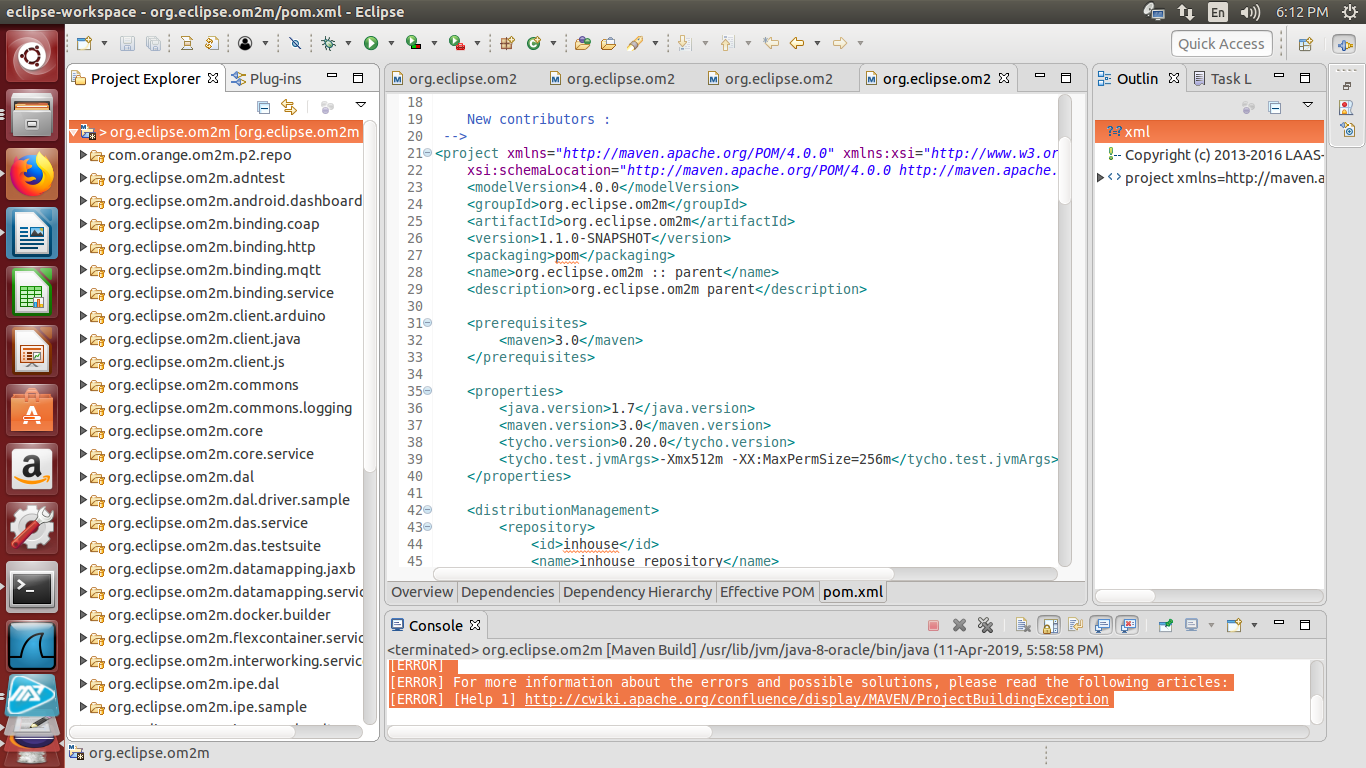

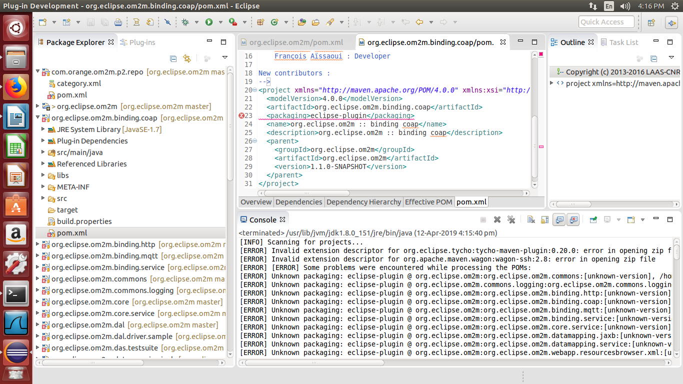

When trying to Run as maven install the following error messages are seen I am not able to resolve it .
Below is the ERROR log snap shot , detailed error shall be in the attachement.

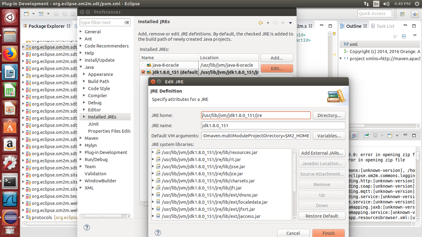

I even tried changing the jdk version jdk8_151 build. Still the observations are same.

1. Why is that the POM files in all the packages wherever are showing an error in the line ? . My observation is it happens while importing the project as existing maven project in eclipse IDE .
<project xmlns="http://maven.apache.org/POM/4.0.0" xmlns:xsi="http://www.w3.org/2001/XMLSchema-instance" xsi:schemaLocation="http://maven.apache.org/POM/4.0.0 http://maven.apache.org/xsd/maven-4.0.0.xsd">
<modelVersion>4.0.0</modelVersion>
<artifactId>org.eclipse.om2m.binding.http</artifactId>
<packaging>eclipse-plugin</packaging>
<name>org.eclipse.om2m :: binding http</name>
<description>org.eclipse.om2m :: binding http</description>
<parent>

4. Why is that these below mention lined as build error , Is there any relation with "eclipse-plugin" attribute ?
<project xmlns="http://maven.apache.org/POM/4.0.0" xmlns:xsi="http://www.w3.org/2001/XMLSchema-instance" xsi:schemaLocation="http://maven.apache.org/POM/4.0.0 http://maven.apache.org/maven-v4_0_0.xsd">
<parent>
<artifactId>org.eclipse.om2m</artifactId>
<groupId>org.eclipse.om2m</groupId>
<version>1.1.0-SNAPSHOT</version>
</parent>
<artifactId>com.orange.om2m.p2.repo</artifactId>
<packaging>eclipse-repository</packaging>
<name>org.eclipse.om2m :: Orange's p2 repo</name>
5. What does the below error means ? , Is there any setting in projects in Luna IDE missing ?
[ERROR] Invalid extension descriptor for org.eclipse.tycho:tycho-maven-plugin:0.20.0: error in opening zip file
[ERROR] Invalid extension descriptor for org.apache.maven.wagon:wagon-ssh:2.8: error in opening zip file

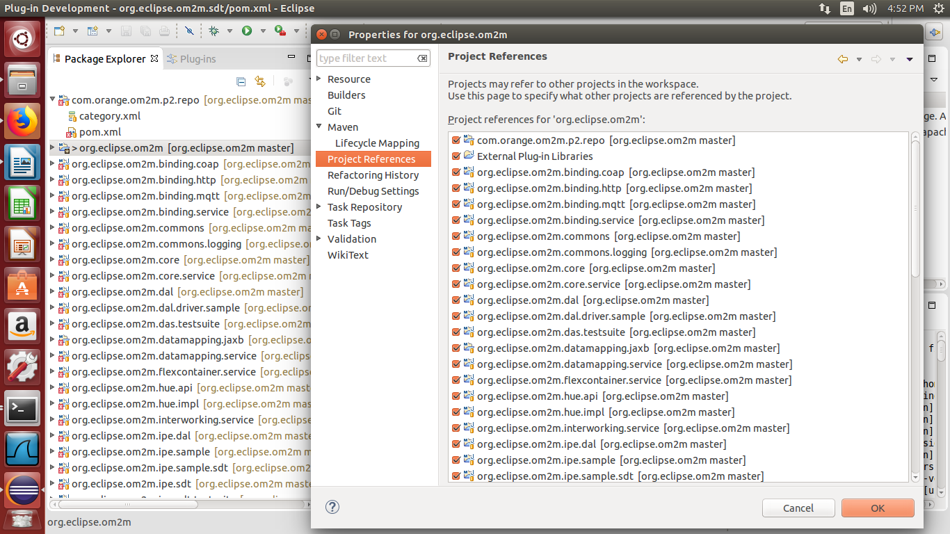

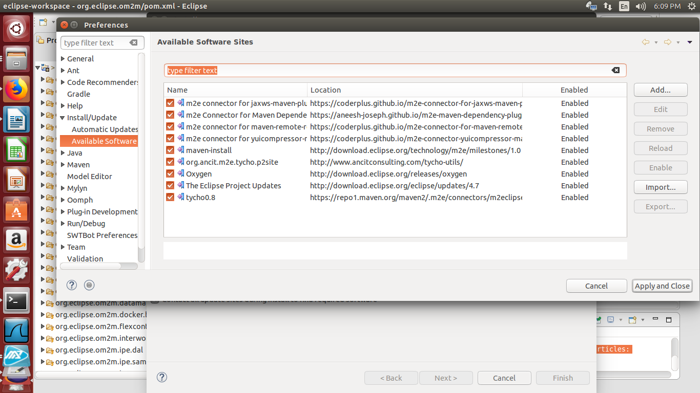

7. I am attaching few of the screen shots and logs which may help to see what i am experimenting. If anything incorrect please advice.
