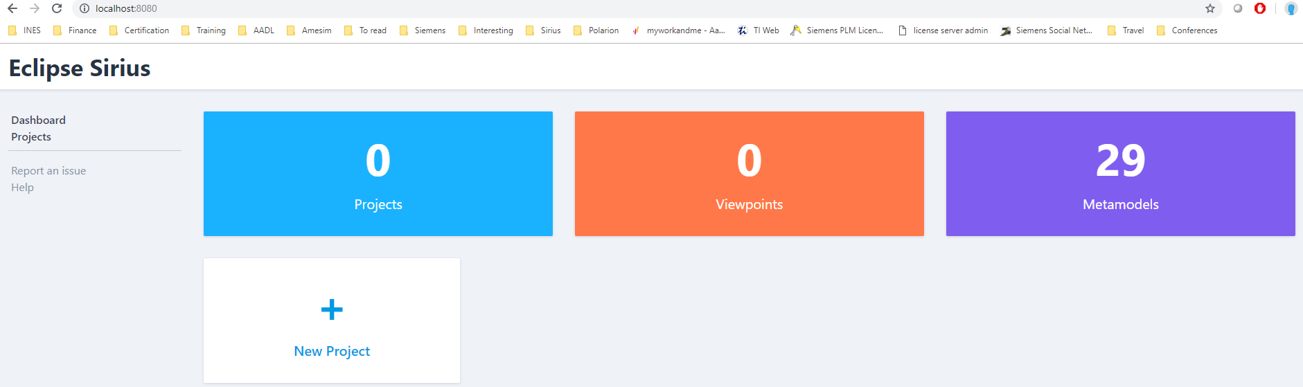

I am not an expert but currently i am looking for ways to add viewpoints to the Sirius server and trying to run them. I managed to get the server running in a docker image by following documentation:
https://git.eclipse.org/r/plugins/gitiles/sirius/org.eclipse.sirius/+/master/plugins/org.eclipse.sirius.server/README.md
When i access the server on my browser it looks like the following:
index.php/fa/35269/0/
There are 29 metamodels but no viewpoints available yet. I now want to add the basicfamily viewpoint to this server. Within the documentation there is a description of a docker file which allows to customize the server:

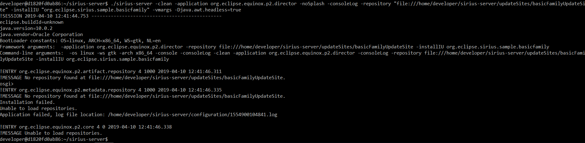

I made an update site from the basicfamily sirius model (zip file) and placed it in the docker file. Inside of a container i wanted to install the updatesite as following:
./sirius-server -clean -application org.eclipse.equinox.p2.director -noSplash -consoleLog -repository "file:///home/developer/sirius-server/updateSites/basicFamilyUpdateSite" -installIU "org.eclipse.sirius.sample.basicfamily" -vmargs -Djava.awt.headless=true
However when i do this i get the message that no repository is found:
index.php/fa/35273/0/
Is this the right way of adding viewpoints to the server? And if yes, what is going wrong?

What you are doing is indeed the proper way to add your odesign and its viewpoints to the server. It appears from the error messages that the URL of your update site is not working.
You should try with an update site deployed on a HTTP Server.
