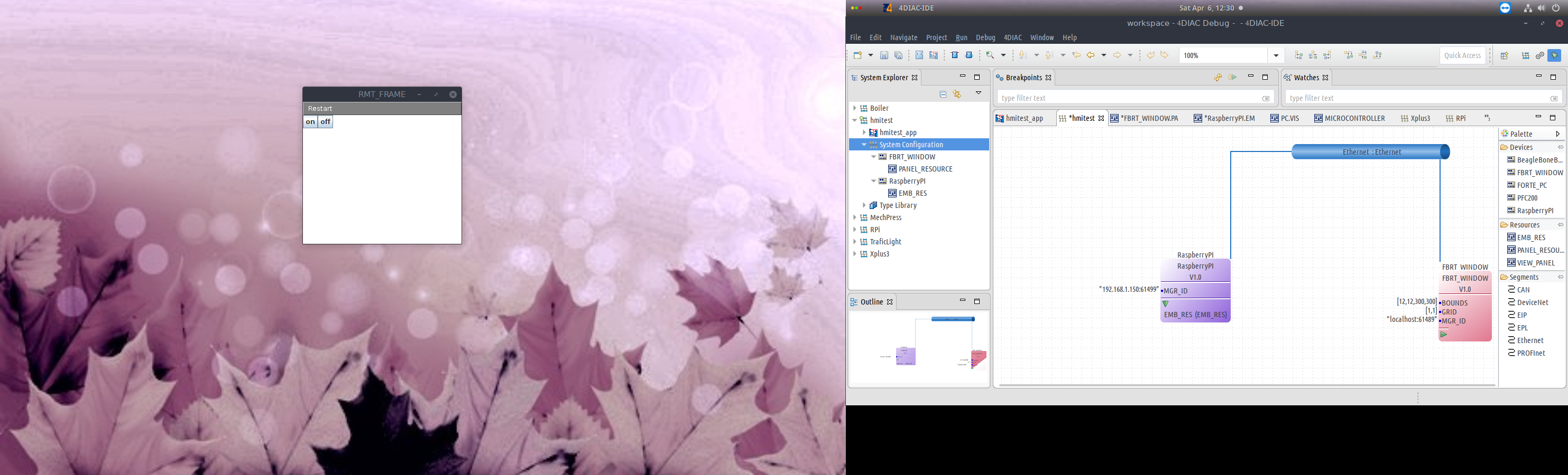

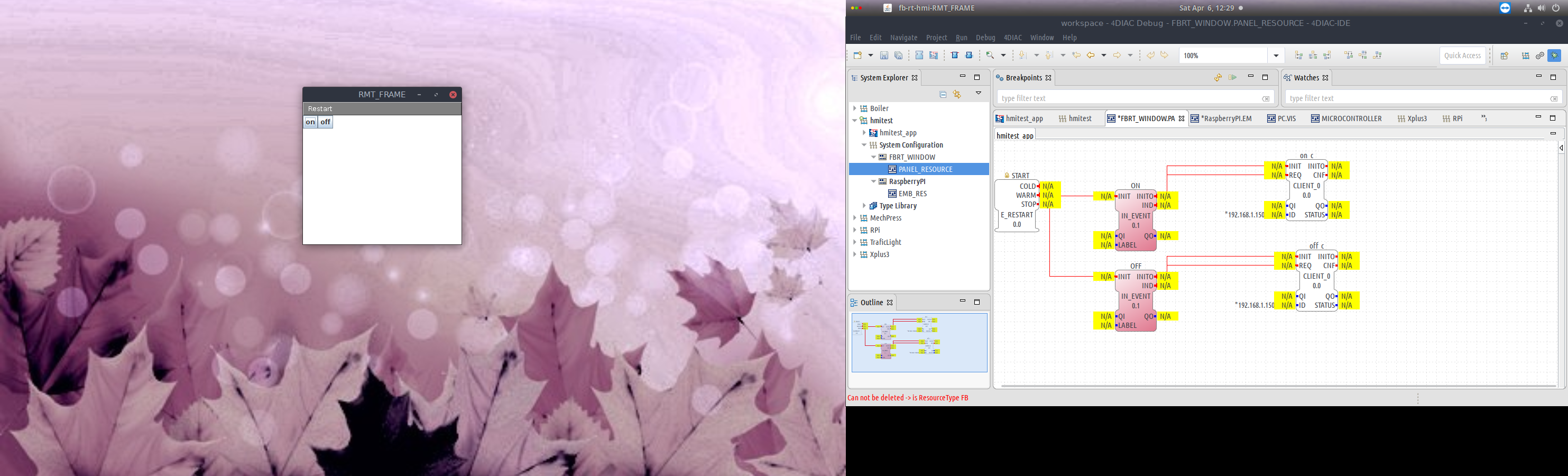

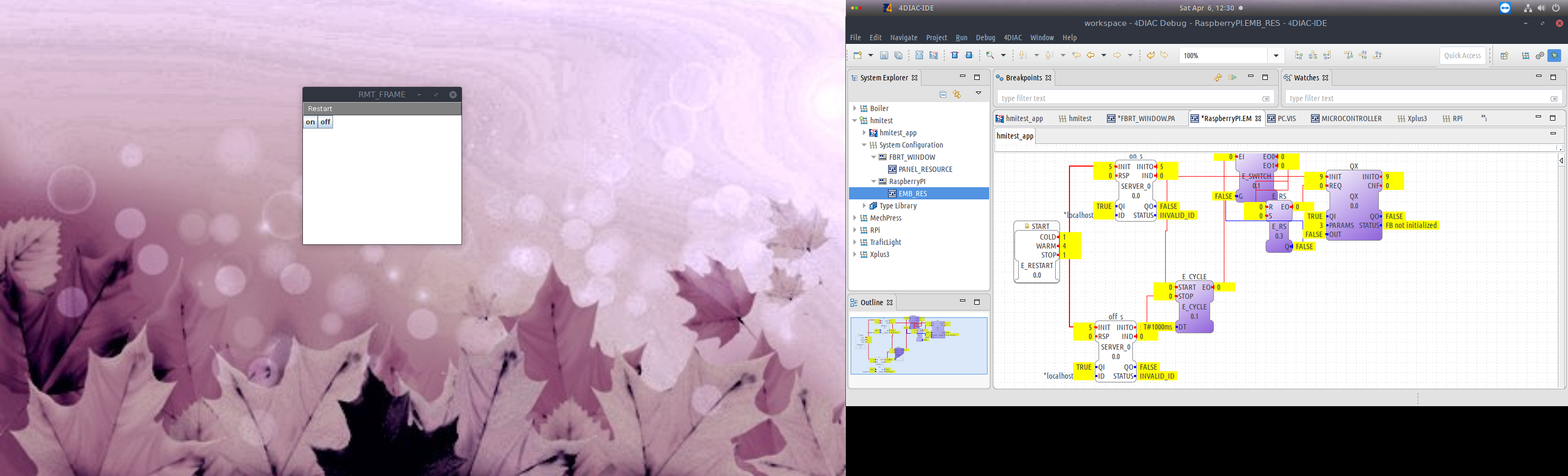

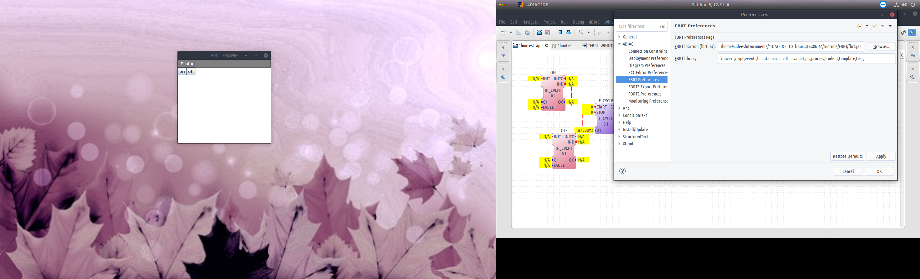

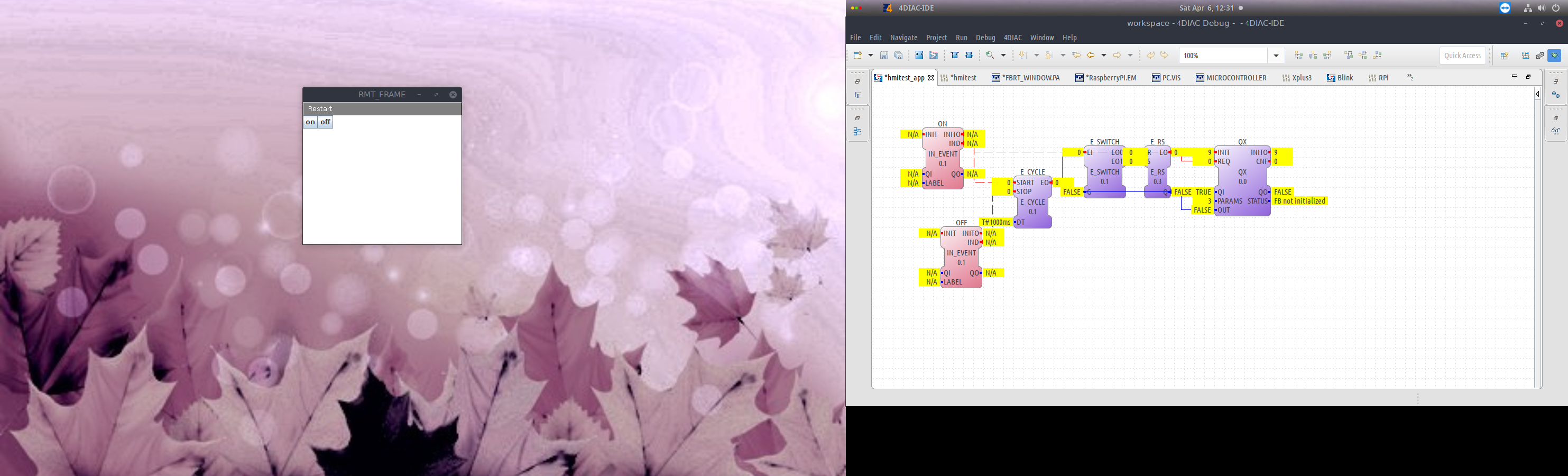

I am trying to create a HMI in 4DIAC with FBRT ,i used 4diac versions 10.0, 1.8, and 1.6 but istill FBRT not working properly . i attached the screen shots . please give me a solution.

unfortunately FBRT does not implement the monitoring protocol that we have in 4diac FORTE. Therefore you can not see the values with monitoring.
