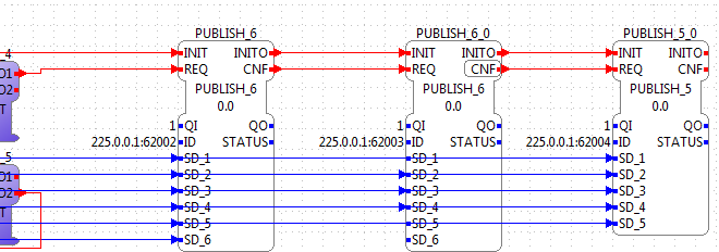

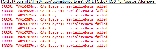

i'm using multiple PUBLISH_6 when trying to send value from FORTE_1 to FORTE_2. But get stuck with this error. CASn1Layer:: serializeData Failed.
Anyone could help, please?
Thank you so much for anyone help.

it's solve OMG, i'm just forgot to include SD_1, SD_5, and SD_6 in PUBLISH_6_0. Thank you so much. Sorry for disturbing your work

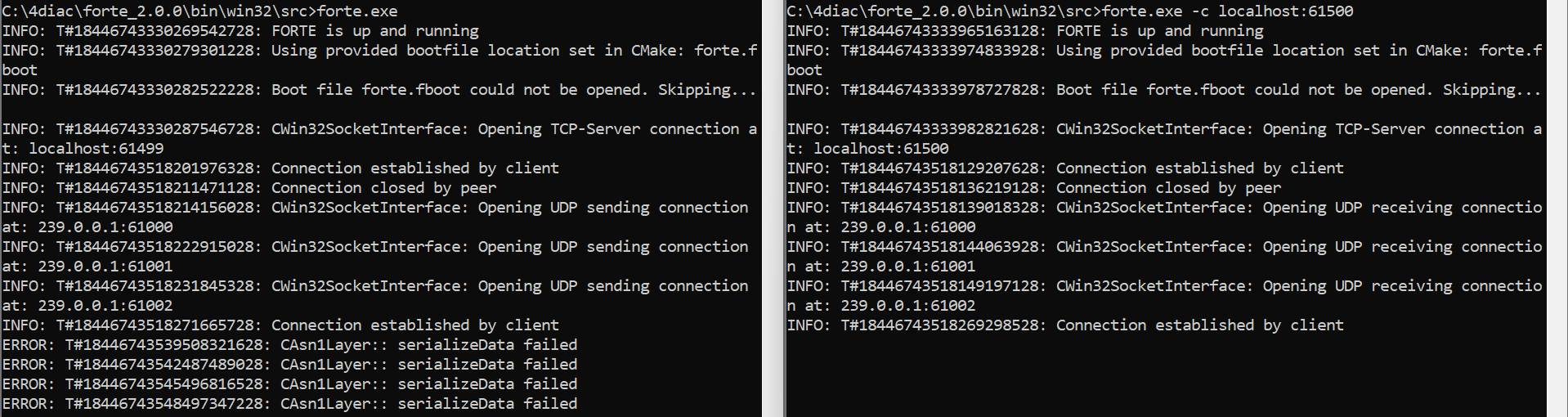

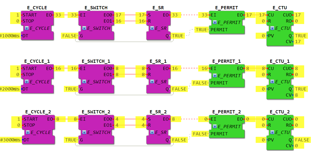

Hi all,
I also got the CAsn1Layer:: serializeData failed, but in my case I'm using the Publish_1, Subscribe_1 FBs.
After several tests it seems that the error is related to the amount of FBs: Up to two is ok, more than that serializeData failed.
In this App I'm using FORTE and 4diac IDE v2.0.0 and the FBs are split into localhost:61499 (blink) and localhost:61500 (counter).
Using multicast UDP at 239.0.0.1 and ports 61000, 61001 and 61002, as the image below.
index.php/fa/42162/0/
Does someone have any idea how to fix it?
index.php/fa/42161/0/

can you show us the FB Network in your 61499 resource?
