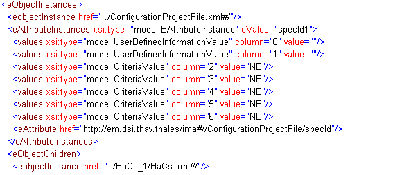

I use a Ecore model for generate domain code for my application.
In this model i have many Reference to a Object locate in a other file whom i don't know the path before i start the application.
This is a exemple of the persisting file,
index.php/fa/35186/0/
I use save provide by emf on ecore

You should measure it with a profiler such as YourKit. A poor-man's approach is to periodically stop the thread and see what it's doing at that point and hope you find the slow thing because it's so long/often on the stack. You're hrefs suggest that each referenced object is in the root of a separate resource so are there really such a huge number of resources involved?
