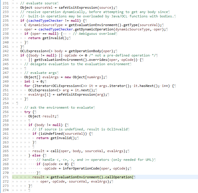

I have an OCL that is failing with an NPE in EcoreEvaluationEnvironment#callOperation since the source argument is null. AFAIK null is only valid for static methods for method.invoke.
When tracing through the code, the issue is that a reference is not found in EvaluationVisitorImpl#visitOperationCallExp as shown in the attached image.
Question: Why isn't the sourceVal being tested for isUndefined when the body is null?

Re: NPE due to null source [message #1804741 is a reply to message #1804734] Sat, 30 March 2019 17:17 Go to previous messageGo to next message
Well that seems precisely in line with the Bug 483246 fix. Navigating from null is invalid. If you use the latest code you will get a clean invalid rather than a dirty NPE and consequential invalid.
If you use a more recent OCL editor you can enable null safe validation so that such hazards are avoided.

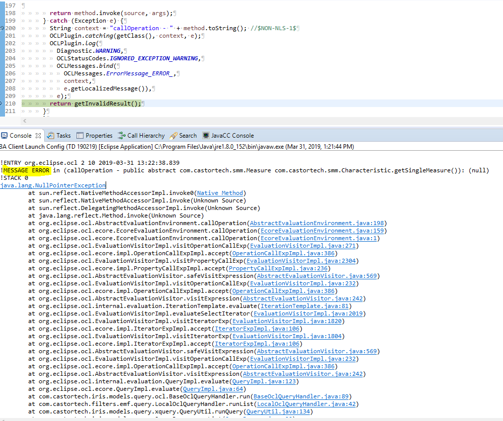

Re: NPE due to null source [message #1804760 is a reply to message #1804758] Sun, 31 March 2019 13:27 Go to previous messageGo to next message
Ed,
Here are 2 screenshots, First is the query from our UI and 2nd is the result with the breakpoint. I highlighted the problematic part.
In this case, as mentioned yesterday, "mc.characteristicDefinition" can return null in some cases, which leads to the exception.

Re: NPE due to null source [message #1804772 is a reply to message #1804760] Mon, 01 April 2019 01:48 Go to previous message
You really don't give me anything to go on.
I don't know what tool you are using. I don't know how you execute the OCL. I don't know how the error arises, except it appears to be a custom caller which strongly suggests that the custom caller is badly coded.
All I see is bad OCL gives bad result. Correct. Poor custom error handling gives user dissatisfaction. Pity, but that's not an OCL problem.
