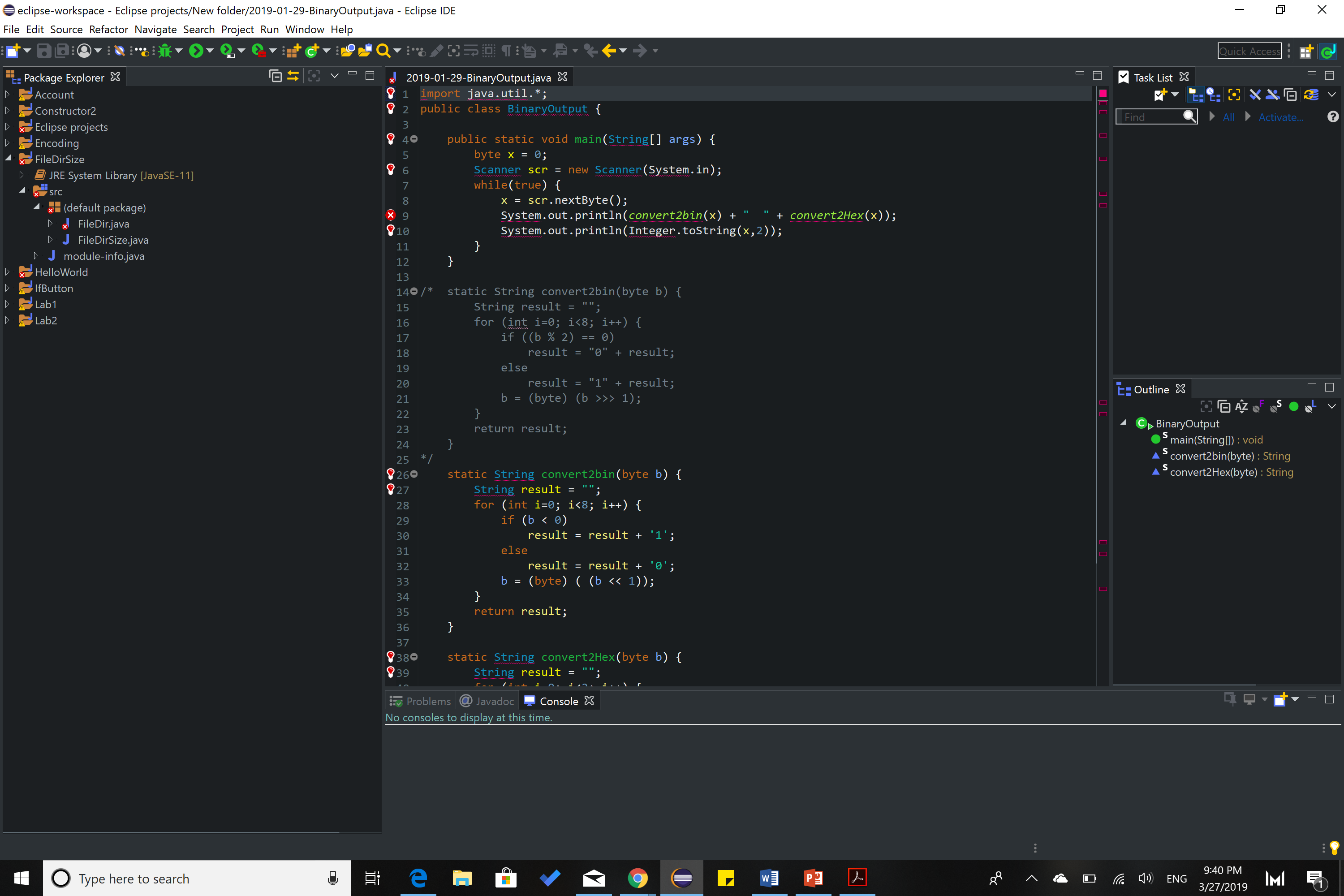

First of all, sorry for my bad English. I am a college student learning how to code. I have recently deleted JDK 8 and downloaded JDK 12. Now, when I create new java files in Eclipse, it generates a file called info-module and I can't just create a class and simply run the program like I did in JDK 8. Basically, all the lines in the code becomes underlined with red and program can't read it. I have attached a screenshot for it.
However, if I choose one of the files I created when I was using JDK 8 and write my code under classes in that file, I can run my program. Can you please help me to solve this problem?

Deleting JDK 8 was not a great idea. You're fortunate the IDE still runs at all. You never know lately from JDK release to release, what will be removed from the JDK or function differently that will cause things to stop working...
In any case, your workspace was likely configured to use the JDK you deleted. So you'll need to go into Window -> Preferences... and look for the JRE preferences (using the search field).
