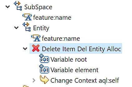

I have an "Entity" inside a "SubSpace" within a tree representation (as in the pic enclosed). The Subspace is not the Container of the entity, it only refers to it. Now I want to "delete" the Entity from the Subspace, i.e. I want to remove the reference from SubSpace to Entity by an unset of the refering variable of SubSpace.
How can I achieve this, when I only have the (semantic) "element" and "root" variables in the delete tool?
