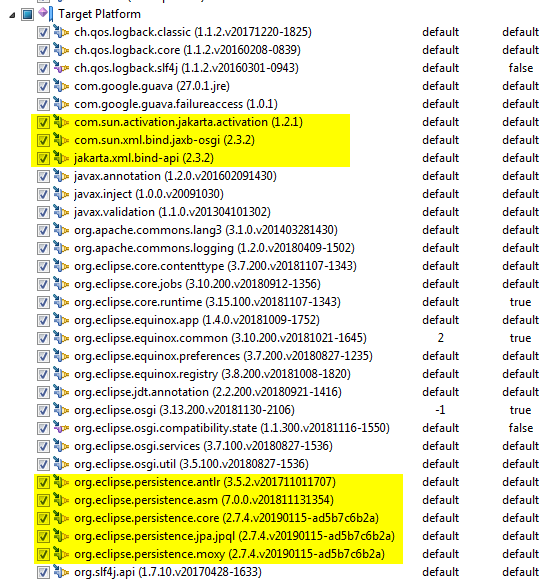

here are plugins selected when starting with J11:
index.php/fa/35100/0/
Frank
