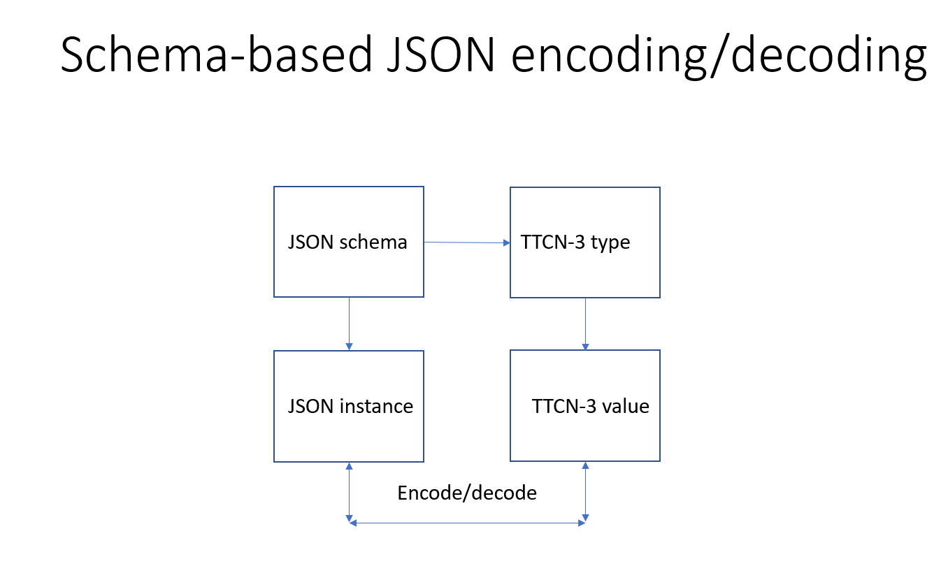

As in XML, a JSON Schema supplies a reference that permits validation of documents (or instances) versus the rules expressed in the schema.
The schema-based encoding/decoding is exemplified in:
Using JSON in TTCN-3 and Titan Part I: Testing REST / JSON web services: (Test of JSON -based REST web services)
https://www.eclipse.org/forums/index.php/t/1068704/
and can be illustrated as below:
index.php/fa/35054/0/

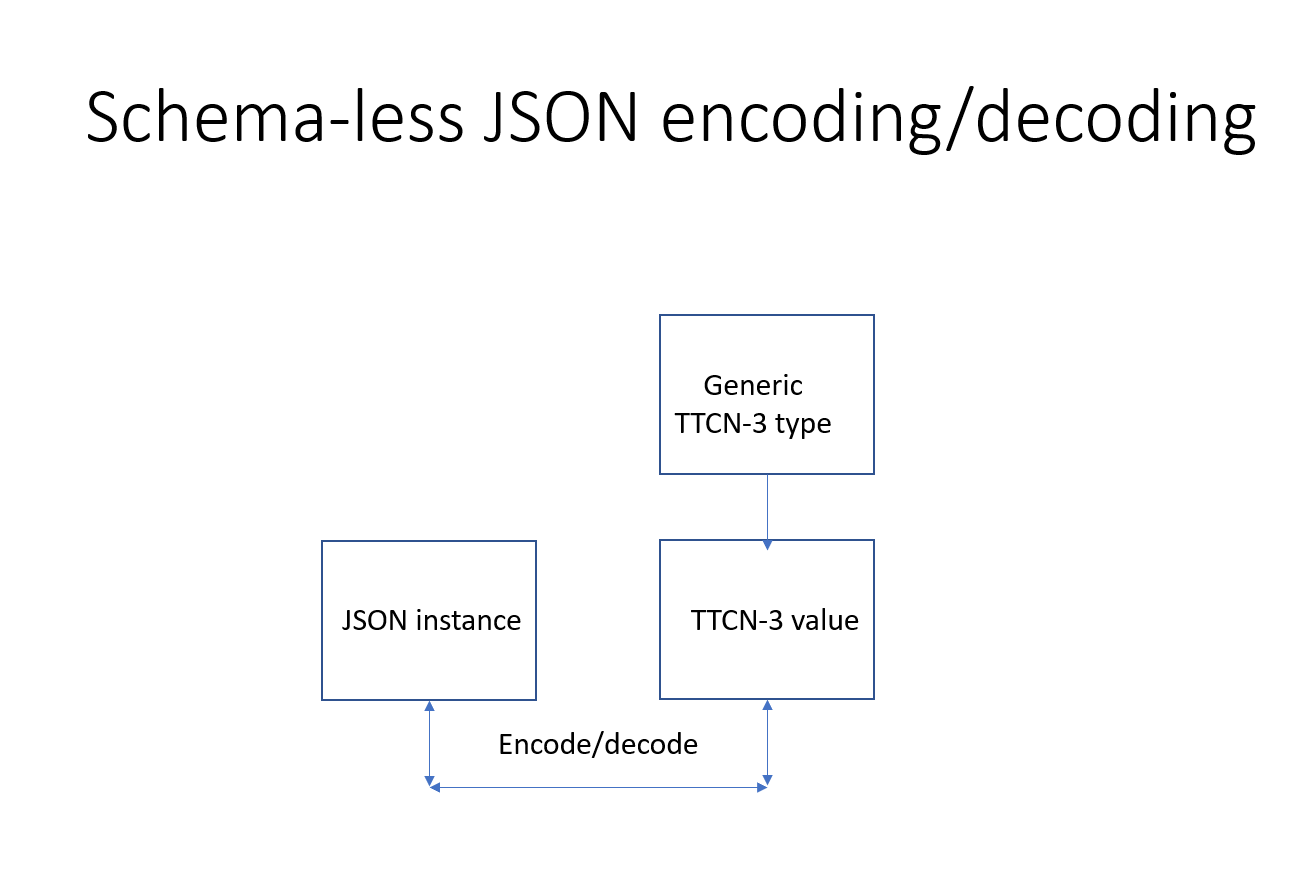

Schema-less processing flow is as below:
index.php/fa/35055/0/

new JSON codec attributes permit now building a generic TTCN-3 structure based not on TEXT , but JSON encoding, which presents a more elegant and
lean solution.
The generic structure that can be used is as below (and will be published as a new version of the protocol module
https://github.com/eclipse/titan.ProtocolModules.JSON_v07_2006

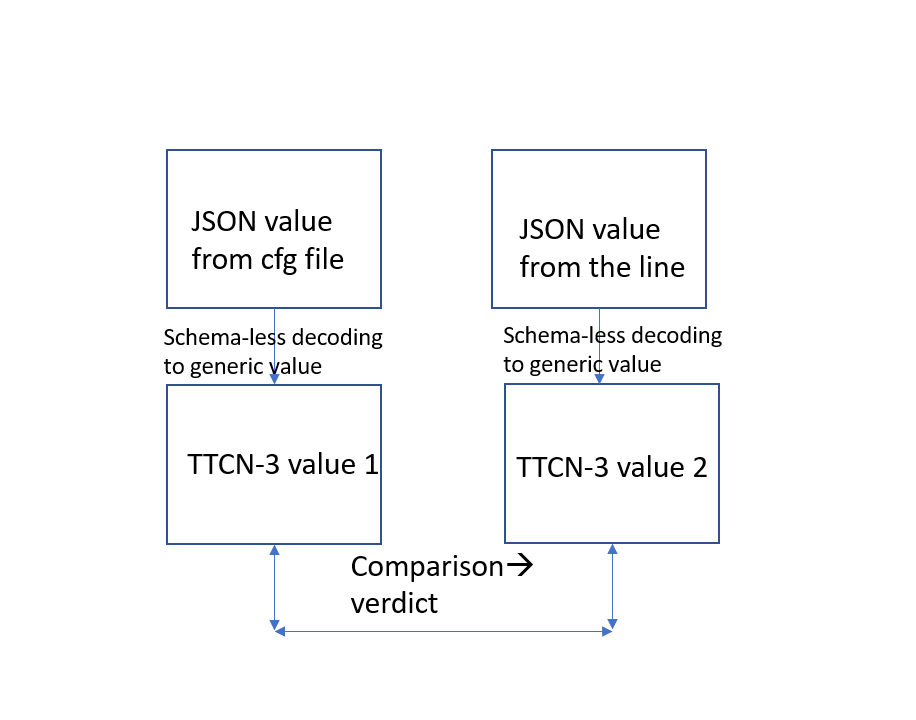

This can be illustrated as below:
index.php/fa/35056/0/
The point to remember is: when you dont't need to validate a JSON instance, schema-less decoding might come handy.
